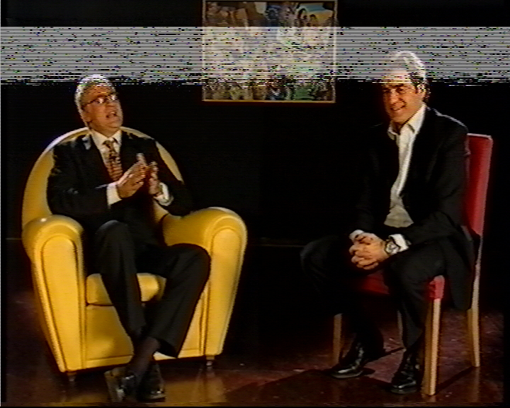

    I would like to know what kind of noise I'm dealing with. Check out the snapshot in attachment to this post.
    These "white stripes" appear anytime I try to capture a VHS tape, indipendently from its condition (good, bad, old, new etc. etc.). They don't always appear at the same point of the video, they're highly unpredictable and seem to be completely random. They usually last just one frame.
    Is there a way to prevent them from happening? I tried cleaning the heads of my VCR but it didn't do anything.
    I tried using AVISynth BadFrame plugin, which seems to work nicely, but I'd like to know more about this kind of artifact I'm getting.

  2. Dropout:
    Brief signal loss caused by a tape head clog, defect in the tape, debris, or other feature that causes an increase in the head-to-tape spacing. A dropout can also be caused by missing magnetic material. A video dropout generally appears as a white spot or streak on the video monitor. When several video dropouts occur per frame, the TV monitor will appear snowy. The frequent appearance of dropouts on playback is an indication that the tape or recorder is contaminated with debris and/or that the tape binder is deteriorating
    source:
    http://cool.conservation-us.org/byorg/bavc/bavcterm.html
