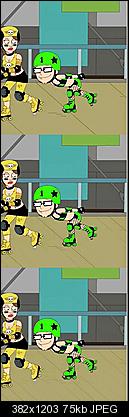

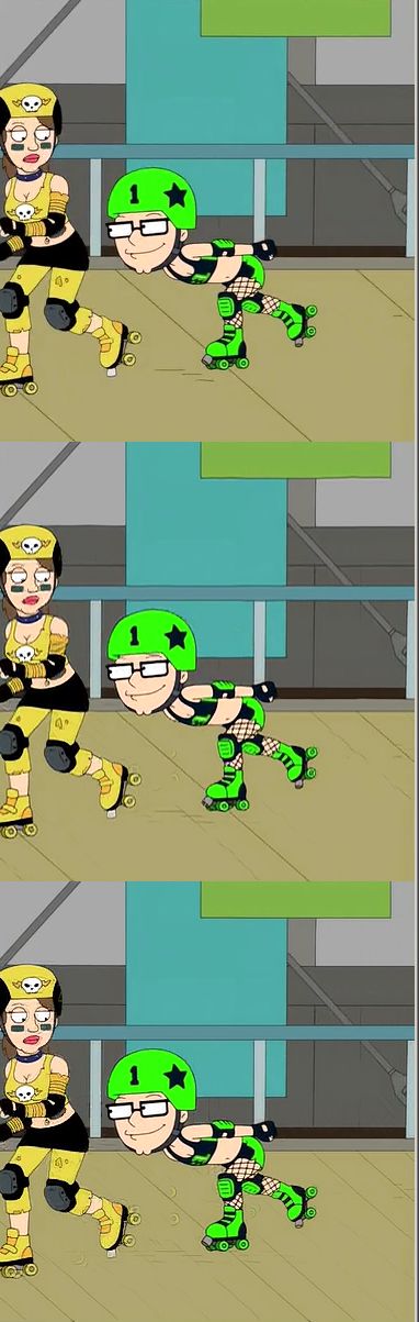

    I'd be somewhat cautious about using QTGMC on animation. It has a tenancy to produce artefacts. This was a progressive source but the top picture is the original, the second is QTGMC de-interlacing and the third is QTGMC in progressive mode. Look to the right of the girl's skates. And there's extra lines on the ground.
Name:	QTGMC animation.jpg

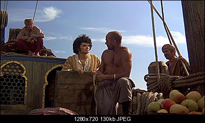

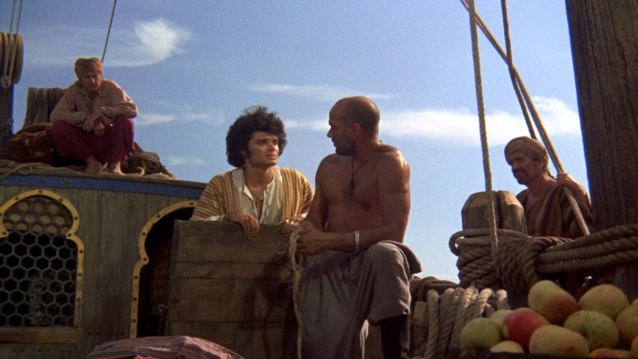

    While I'm in full disclosure mode, every filter comes with side-effects, and because QTGMC is a de-interlacer it can sometimes have an undesirable effect when an object is at just the right angle. Here's an example. QTGMC & LSFMod & Gradfun3. I probably should have backed LSFMod off a little (it's borderline over-sharpened) but check out the rope at the top left. I think it was on just the right angle for QTGMC to remove the detail. The rest of the picture looks improved enough to me to make up for it though, and I don't notice that sort of thing often, but it can happen. You'll probably need to open each in a new tab to view them full size because the forum software sharpens a lot.
    Before
    After

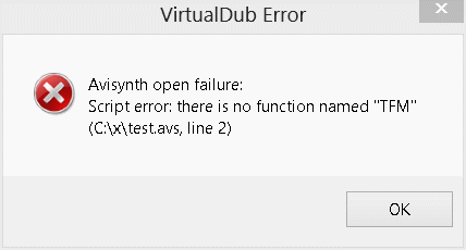

    Okay, I tried just this script, and it threw an error:
    DirectShowSource("C:\x\00000.mkv")
    TFM().TDecimate()
    Addborders(80,0,80,0)
    And, YES, the reason why I am using DirectShowSource could be because I use BDRB a lot, or at least I did until I started learning more about using the CMD line which I do now more and more, thus my wanting to incorporate Avisynth. Mainly though, just for older captures like the one I posted on the other thread. I'll put it here too. ONLY really in cases like that will I be messing around with trying to 'improve' them because there is no commercial source for some of these films. Also, I think the very fist tutorial I read about Avisynth said to use DirectShowSource for files other than avi. So, since I will pretty much only be doing this stuff with MKV files, that is where I learned to use that.

    Yes, that does help me understand it better. I don't know what you mean by 'autoload' folder. I THINK that I just have a 'plugins' folder where all the .avs, .avsi, and a LOT of .dlls are. All I 'knew' was that if a function had an .avsi extension, that it was automatically loaded when you used Avisynth, so you didn't have to include a line loading it.
    I THINK you asked me to try to open my .avs file in VirtualDub, right? Well, I just tried this new streamlined one above and I took a snapshot of the error. I'll upload it here.
    Oh, and I will paste THIS page on the other threads where people have answered. I just read your post about DirectShow and yes, for BDRB I do have LAV installed, etc. So, if for now I can please keep it simple and just use that until I get 'better', I'm pretty darn sure that at first I will be doing entire encodes and I won't be playing around with the frames, etc. Please let me know if you think that is all right. Thanks!
Name:	VD error.gif
  11. It's so easy to miss mistakes in scripts. I've saw a mistake in yours here yesterday, then the same mistake in your other thread today, and here again now before it registered.
    Scripts aren't plugins so you don't use LoadPlugin. You import them. Not that you need to if they're in the plugins folder with an avis extension.
    Incorrect:
    LoadPlugin("C:\Program Files (x86)\AviSynth 2.6\plugins\LimitedSharpenFaster.avsi")
    Correct:
    Import("C:\Program Files (x86)\AviSynth 2.6\plugins\LimitedSharpenFaster.avs")

    Oh, Geez... well, that is a good start... Okay, so for any SCRIPTS (.avs) I use 'Import' as you stated above. Very good!
    I'm curious though... I wonder why when I just put LimitedSharpenFaster() in the script why it didn't work? The avsi is indeed in my plugins folder.
    BTW, Sharc suggested (as a start) that I try using BDRB to import the MKV file and then render it using inverse telecining in BDRB's ini, which I'm doing (takes a bit longer than usual) So, that should HOPEFULLY take care making it progressive and getting rid of what I THOUGHT was interlacing (some combing, etc.) Then, what I hope to do is take the resulting m2ts file and go from there with Avisynth.
    Does that sound like a good idea, do you think?
  13. If there's no function named TFM, it's going to be because you don't have the TIVTC plugin. http://avisynth.nl/index.php/TIVTC
    The plugins folder installed by AVIsynth (ie C:\Program Files (x86)\AviSynth 2.6\plugins) is the one that AVISynth checks every time it runs and automatically loads any plugins it finds (including avsi scripts). That's why I referred to it as the auto-loading plugins folder. If you want to use a dll residing in any other folder, you have to load it yourself.
    Not everything auto-loads, but most plugins do. There's a link in my post yesterday which takes you to a page explaining the workings of the plugins folder.
    Yeah, I pretty much figured that I didn't have what I needed for that function. Yes, I will review the workings of the plugins folder for sure. See what you think about BDRB's code...

  21. Originally Posted by Lathe View Post
    Soooo, I wonder what I should do next...?
    Is your source the 01.mkv attached to a post somewhere? This isn't going to be the ultimate, "nothing does it better" method. That requires experimenting and tweaking for individual videos and experience I don't have. This is my go to "clean it up a bit" filtering. Someone else with more experience with your type of source might be able to suggest something better.
    QTGMC is a de-interlacer, however it has a progressive mode for cleaning up bad deinterleaving a little, and that mode makes for a good noise remover (what this thread was originally about), and after IVTC you have progressive video. So....
    TFM().TDecimate
    GreyScale()
    QTGMC(InputType=1, EzDenoise=3)
    crop(12, 4, -8, -4)
    Spline36Resize(640,472)
    LSFMod(Strength=50) # I wouldn't bother
    gradfun3()
    I doubt I'd bother with sharpening, because even after noise removal there'll be more noise than detail to sharpen and by the time you sharpen any detail it'll look like crap. That's just my opinion, and someone else might have other ideas.
    gradfun3 combined with QTGMC will help repair some of the encoder "blocking" and gradfun3 will add dither to reduce any banding.
    I'll probably have to return tomorrow but someone else might be able to help with getting QTGMC and gradfun3 working. You'll be in duplicate plugin territory (different scripts with dlls in common) and some scripts come with different versions of the same plugin.... generally you need the latest version of each plugin with no other version in the auto-loading folder.
    Gradfun3 is a function of the dither package found here:
    http://forum.doom9.org/showthread.php?p=1386559
    The dither package requires dfttest 1.9.4 and MVTools 2.6.0.5. Links on the same page. If any other scripts come with dfttset, mvtools2 or whatever's in the dither zip file, delete their versions and use the plugins from the post I linked to instead.
    You really are polishing a turd, but here's the result of the script I posted, without LSFMod().
    The mkv doesn't want to work as an attachment for some reason. I'll try adding it manually.
    https://forum.videohelp.com/attachment.php?attachmentid=38962&d=1476865356

    Wow, that looks amazing, considering... Thank you for taking the time to do that. And that is BEFORE I ran it through BDRB and make it progressive, but I'm guessing your script likely did that anyway.
    Yeah, 'Turd Polishing' is my new hobby, go figure... Appreciate the explanations about the script and such though. I will continue my reading and research about that and see if I can actually begin to catch up before I die of old age...
    Oh, just a quickie... EVERY bloody AVS package comes with DOC and SOURCE folders, and they all look the same. What do I do with those when I go to add the files to my plugin folder? I KNOW that I will need at least the .avs or .avsi and .dll files there, but what do I do with all the rest, especially since every plugin has those folders?
    Cheers!
