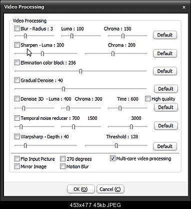

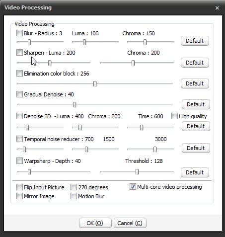

    Video processing filters are turned on by right clicking and going to Video -> Video Processing. CTRL-R is the sharpness default. But to find them and adjust right click screen and go to Video -> Video Processing -> Video Processing Settings:
Name:	ScreenHunter_18 Aug. 11 08.12.jpg
    To reset navigate again or hit the Q key

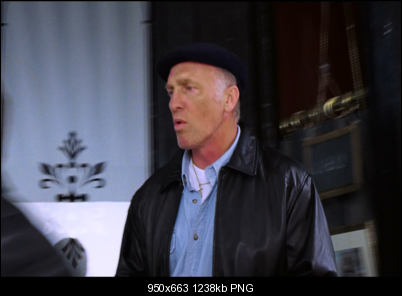

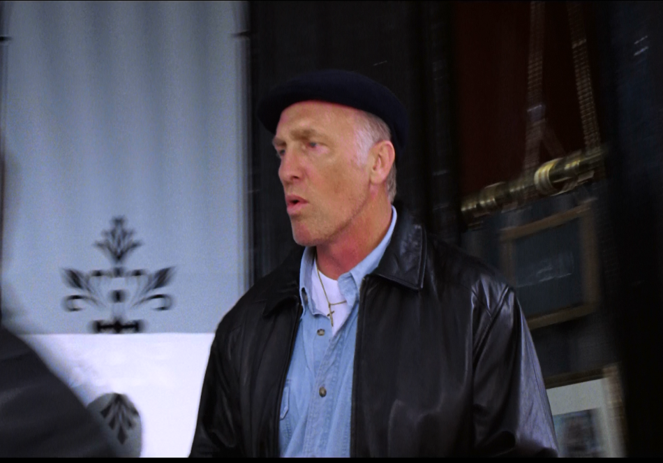

    Jagabo -I had a look at that post and changed a few things didn't seem to make a huge difference its seems to be manly with skin tones amd has a setting you can use to after it but doesn't seem to help much. here is a picture of what it looks like it looks worse when its actually playing .Click image for larger version
  12. Originally Posted by hd7970 View Post
    That's probably a graphics card driver problem, not a player or codec problem. When a media player plays a video it decompresses the video to YUV and gives that YUV to the graphics card for display. The graphics card converts the YUV video to RGB before sending it to the monitor. It chooses what matrix to use for that conversion, typically rec.601 or rec.709. It can decide on which to use based on information give to it by the player (the matrix can be specified in the video), or it may assume rec.601 for SD, rec.709 for HD, or it may just pick arbitrarily. As it performs that conversion it may also use its video proc amp to adjust brightness, contrast, colors, etc. It's also possible for the player to adjust the video before handing it to the video renderer.
    Note that players have several choices of video renderers (the software device used to get video to the screen). Some work better than others and they may have different processing. Different players may default to different renderers.
    So you need to control for all these variables.
