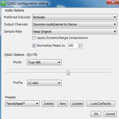

    Here are the settings i'm using with qaac in megui
    do they look okay or am i doing something wrong? I'm not really an audiophile. So i don't know a ton about encoding audio. I usally just used the default settings when encoding with foobar. The only thing i did was apply the downmix to 2.0. I've never really messed with dB or anything like that. I figured if i'm going to start using the better encoder i might as well do it right.
  16. That looks fine. The "too quite" downmix is due to the way MeGUI downmixes. It creates an AVIsynth script to do the downmixing. If you're keen you'll find it in the log file but there's nothing you can do to change it and you probably shouldn't anyway. Selecting the "normalize peaks" option will effectively get MeGUI to increase the volume again (peaks at maximum).
    I'm pretty sure the volume will only drop when downmixing. If you convert multichannel to multichannel or stereo to stereo you should get the same volume as the original... unless of course you also check the "normalize peaks" option, in which case it'll be errrrr.... normalised too.
