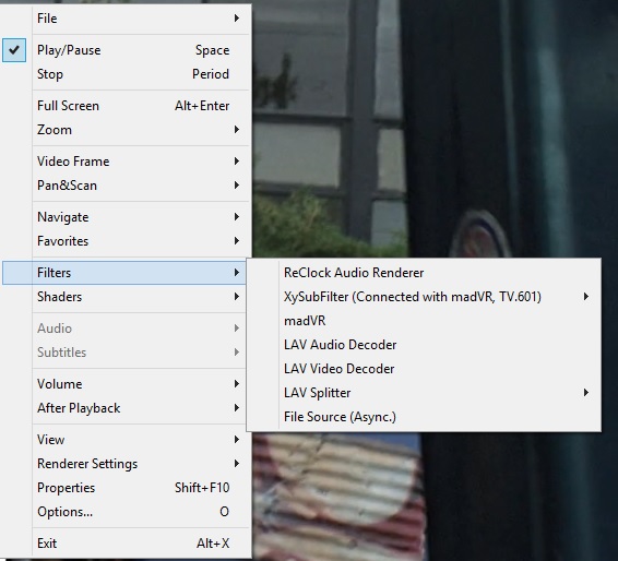

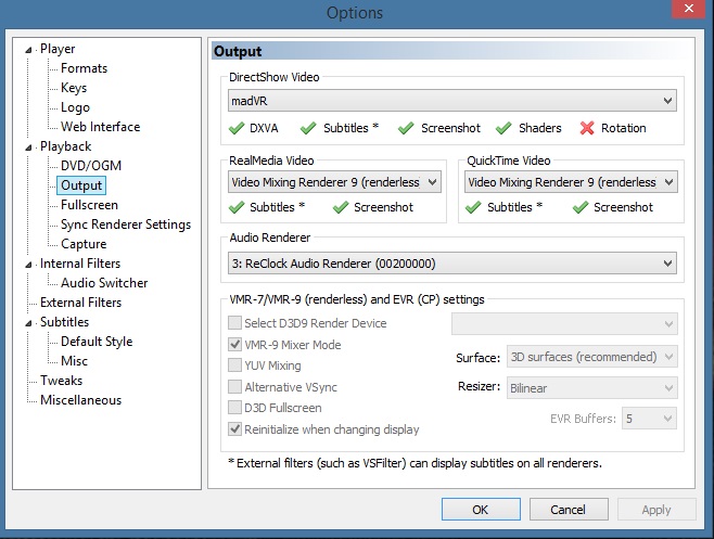

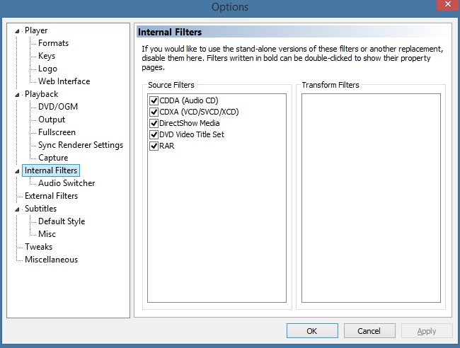

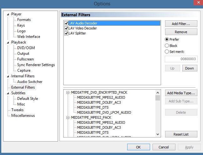

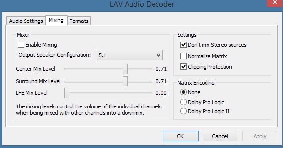

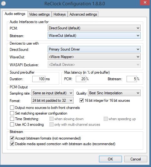

    See the screens below. I am using ReClock and LAV Filters. I played a little with the settings but whit no success so far. Thanks in advance

    I can't remember exactly, but the above doesn't work with every renderer. It definitely works with the WMR9 (renderless) and EVR (custom presenter) renderers. You can select the renderer under Output in Options (restart MPC-HC for the renderer change to take effect).

    Hey... I had the same issue. I am working with a MPC-HC + LAVfilter+MadVR setup.
    What I did to resolve this: in the MPC-HC menu, I went to external filters. (you can also get there while playing a video/ audio file: right-click-> filters-> LAV audio decoder). I double clicked LAV Audio Decoder. Under the sub menu "mixing" I enabled mixing, set it to stereo, which was what I needed (but you can edit this depending on preferred setting, 5.1, 6.1 etc). That's it.. Volume was exponentially increased!
