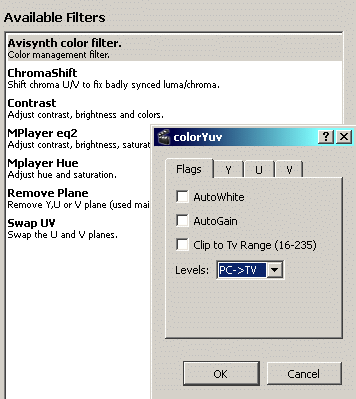

    Logically, if the Avidemux encode looks too dark, it's probably re-encoding without converting the levels.
    That doesn't necessarily mean it's a bad program, maybe more that it's just not making assumptions.
    It seems it does have a filter for doing so.
    As well as a "darkness" problem, it's also possible the colours might be slightly different (ideally they should look
    the same as the original video). How do the colours of the Handbrake encode look when you compare it's encode to the original
    side by side?
    Or more importantly, how does the Handbrake encode look when compared to the game itself?
