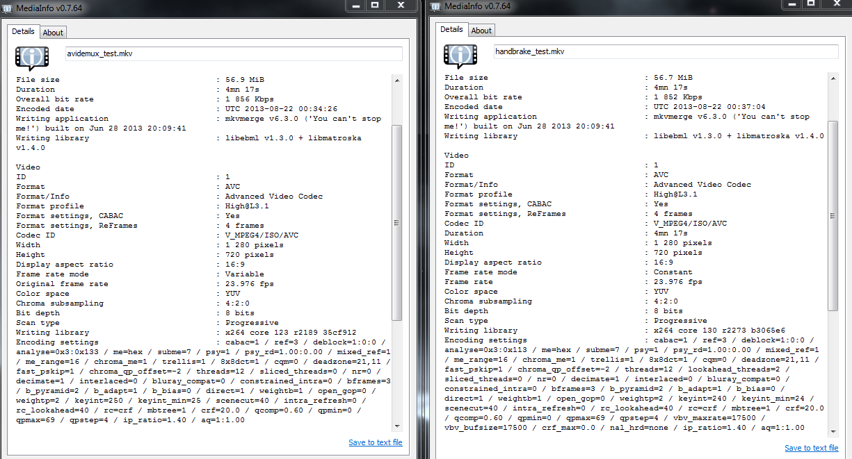

  1. But - Did you notice it get substantially faster than your previous tests on core 106 ?
    You're still using older libx264 r2273 vs. r2189
    If you look at the x264 changelog , there were a bunch of speed optimization commits during that time, also some affecting SandyBridge, IvyBridge AVX (not AVX2) sets
    https://www.videohelp.com/tools/x264-Encoder/version-history#changelog
    Try using the version hello_hello used . I'm not sure where he got it. It ended up slightly faster (ok, not really if you account error margin) and smaller filesize at the same settings
    Guess what? If you use the exact same x264 revision - you will get the exact same encode, exact same speed - assuming all the other things like decoding, processing are the same

  4. From your MediaInfo I can also see that Handbrake is using VFR. Turn that off and try again.
    In my experience, Handbrake trades off an almost imperceptible amount of quality for speed. Which is why for important transcodes like backups, I avoid Handbrake. If it's just for my mobile or tablet, Handbrake is fine. But not on an HD monitor, the flaws are apparent. You can tell if you look carefully, Handbrake's quality is slightly worse than other encoders with the benefit that it encodes slightly faster. It must be the settings are different. x264 has an alarming number of settings under the hood.
    That said, it shouldn't be faster if you match the settings of other encoders exactly. I have never liked Avidemux as it has always been buggy and terrible at h264. Though I'll admit I haven't looked at recent builds.

  5. Originally Posted by blud7 View Post
    He said to use High Profile and I used all default settings - Variable Frame Rate being one of them.

    I understand that. I'm pointing out that even Handbrake's High Profile setting is non-standard.
    If you want a true comparison, they have to be exact IMHO

    Just because MediaInfo says one encode is VFR and the other CFR, it doesn't mean it made a big difference, but it could if the source video is VFR and Avidemux converted it to CFR. It may be Avidemux doesn't understand VFR and just assumes it's CFR. I don't know, but it'd be better to compare speed using a CFR source video so they're definitely both encoding the same number of frames.

    Handbrake producing a different file size and bitrate could mainly be due to it using variable frame rate encoding.

  23. Since no one responded I made another clip. This time shorter only 1 minute 45 seconds instead of 13 minutes.
    Handbrake 1:29
    Avidemux 1:36
    Handbrakes file was 5mb smaller. Also with Avidemux the colors always seem to be darker in the video.
  24. 1. Still different versions of x264
    2. qpmin / qpmax different
    3. Handbrake has nal_hrd explicitly disabled
    4. Keyint is different
    5. Handbrake is showing lower bits/pixel which would indicate lower quality (but not necessarily)
    1 & 2 are the most important here. Especially 2.

  26. Originally Posted by DUDERANCH View Post
    I copied the exact settings from hello_hello's post. So then there are some settings he didn't tell me...
    He needs to send me his version of Avidemux. I have a newer version of Avidemux, but he has a better x264 version? It doesn't make sense.
    Handbrake looks better quality to me. Avidemux is too dark.
    By different versions I don't mean different from what he has, I mean it's clear that the programs are using different versions of x264.
    hello_hello has done great so far but x264 has many settings. It is easy to miss one.
    I don't see how one output could be darker than the other unless you used a filter. Anyway, I did my own encode, copied audio.
    I then remuxed both with mkvmerge to make sure of exact filesizes (muxing can alter file size as well)
    avidemux 1:18:00
    handbrake 1:23:07
    Handbrake took about 5s longer to produce a marginally smaller file. (Before remuxing, file sizes were the same both 56.8 MB)
    Look at the bit rates, they are near identical. (1856 vs 1852)
    With bitrates that close, this can be attributed to some tiny variation, probably x264 version.
    Both encodes look identical to me, none is darker or blurrier or anything.

  27. There's still variables not caused by encoder settings such as the variable frame rate output verses a constant frame rate.
    To be honest I don't think the differences in encoder settings would effect the result too much, but I simply went to the
    Avidemux page on this site, downloaded the portable 32 bit version, unzipped it to a folder and ran it.
    If you want to use the same version of Avidemux as I did, that's the one.
    Don't you have a standard Xvid/Avi you could use for re-encoding tests? Something which will have a constant frame rate to begin with?
    The fact you're saying the encodes produced by each program have differences in terms of brightness/colour is also a problem,
