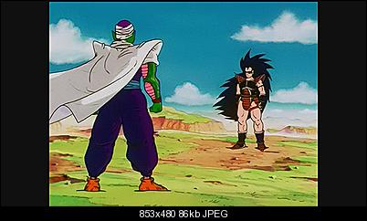

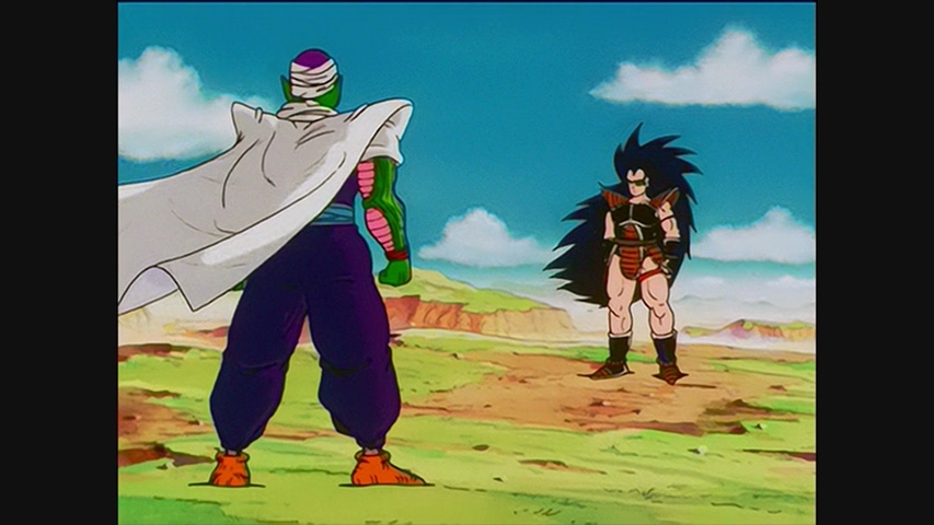

    Both images below are displayed in a 16x9 panel. The top image has been cropped to 704x480 but not resized.It has been encoded at 704x480 with a flag for 4: display.
    The bottom image was cropped to 704x480, resized to 720x480, and encoded at 720x480 with a flag for 4:3 display. You can see that the bottom image is wider in the bottom panel. The same thing would happen if the 704x480 image had been resized to 720x536 and resized again by the encoder at 720x480.
    If you click either image to enlarge, you can switch your view back and forth in the forum viewer by clicking "Previous" and "Next" in the viewer. The change in size will be even more apparent.
    Besides that, all the resizing will introduce artifacts to some degree into the bottom image.

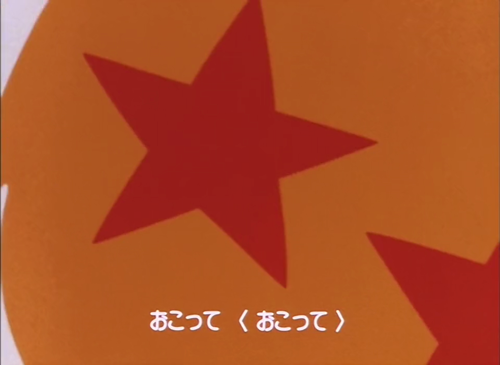

    Increased the resolution to see if I get rid of a problem, but another appeared.
