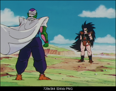

    Well...if you look really really really close and for a long time, there is some line softening and a pinch of chroma shift or bleed (1/2 pixel?). The right side of the distant figure's white cape shows a smidgeon of red along one edge. Here and there, a remnant that looks like ringing. That sort of thing.
    I hit the image with DeHalo_Alpha and corrected a more annoying problem (for me). There are no clean blacks. They're blue. Is the big guy supposed to have blue hair?
    [Attachment 19651 - Click to enlarge]
    Maybe a moving image would show something more apparent ?

  24. Banned
    New York, US
    Lines look very slightly soft due to low bitrate (if you blow the image up a few times), but I don't see aliasing.

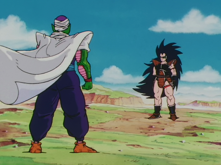

  28. Watch the videos:
    https://mega.co.nz/#F!ssIEFTjZ!e9xkGyMCzo9XKT6FBY3p4A
    password: dfg
    When you reach this point, compare both:
    Look the legs of Raditz, the outline or edges of the image are blurred in my version. And in another video that does not happen. That's what I want to solve.

  29. Banned
    New York, US
    Your version is sharper and cleaner than the original. The original suffers from a very low bitrate (and so does yours) and frame hopping. You can't expect a low bitrate to "raise" the quality of the original. IF you want to get better quality, then filter as you have done, then stabilize the image and use a higher bitrate. The lower the bitrate, then less data is present to properly describe and control the image.
