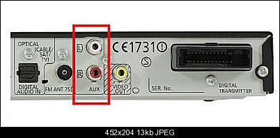

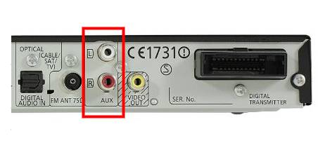

  4. Originally Posted by everton View Post
    Hi, unfortunately, so far as I can see there isn't an RCA audio out on the btt 590
    This device? http://www.amazon.co.uk/Panasonic-SC-BTT590EBK-5-1ch-Blu-ray-Cinema/dp/B007RTY4I6/
    What's this?
    Is that an input or output? I guessed it was an output since it was right next to the composite video output. Is the SCART connector there an output? If so you can use something like this:
    http://www.amazon.co.uk/Switchable-Scart-Phono-S-Video-Adaptor/dp/B0018DE4ZU/
    Aug 2013
    london
    I believe it is an input only, as when I plug my RCA leads in (red and white) from the wireless headphone cradle there is no sound, unlike when I plug the same leads into the tv (sky+ hd) box
    Aug 2013
    london
    And yes that is exactly the right system, thanks
    Aug 2013
    london
    The scart is the wireless speaker card slot
  8. Oh, I see. It's not a SCART connector. I think you're right about the RCA connectors. After looking at the manual online -- they are for audio return from the TV (ie when using the TV's tuner you can still have audio coming from the home theater system).
    Does your projector have RCA monitor outputs? Nevermind -- found the manual for that too. It doesn't have audio monitor outs.
