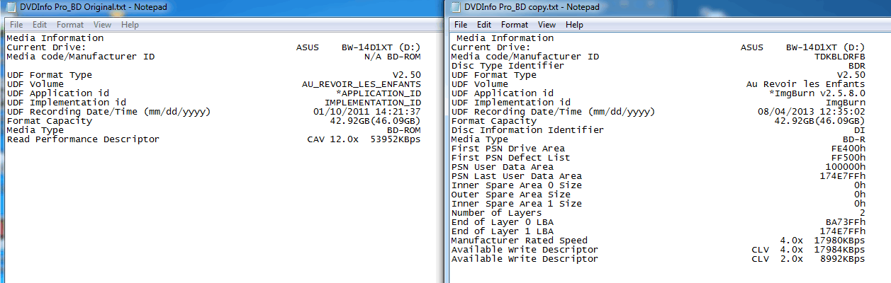

    I don't know if this pic from DVDInfo Pro is of any help.
    Nope, I don't have PowerDVD

    Of course the report from DVD info pro does not give any details of the zone so one could reasonably accept that this new disk is zone-free.
    To be sure, I would also run the original Criterion disk through the same report just to see if there are any differences in the report - I notice a blank line.
    If you were to invest in PowerDVD Platinum, you could play the original disk in your PC assuming, naturally, that it has a BD drive.
