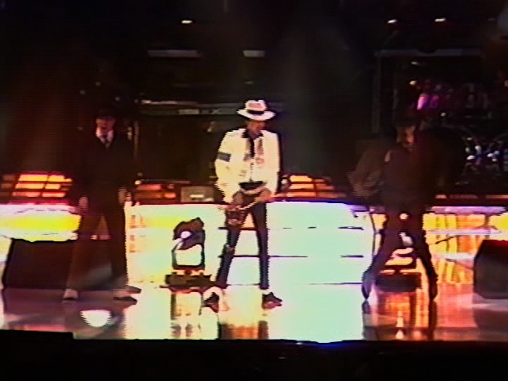

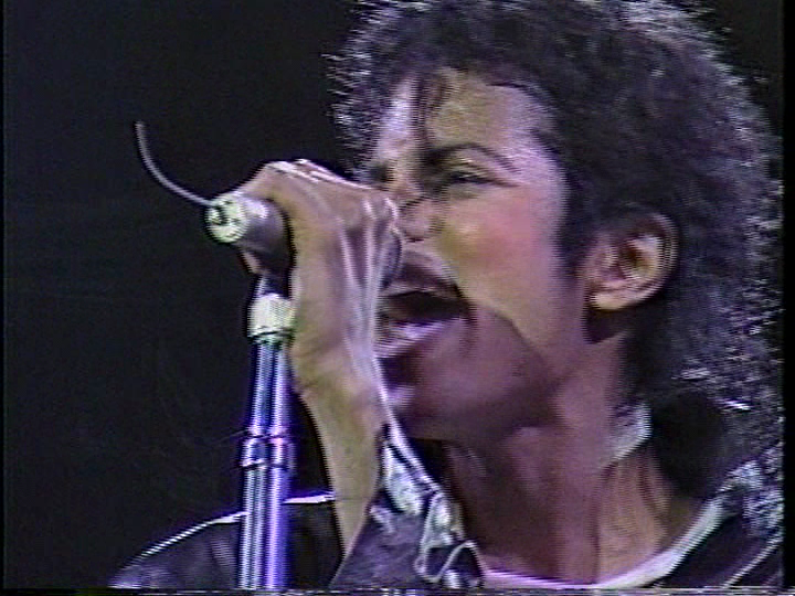

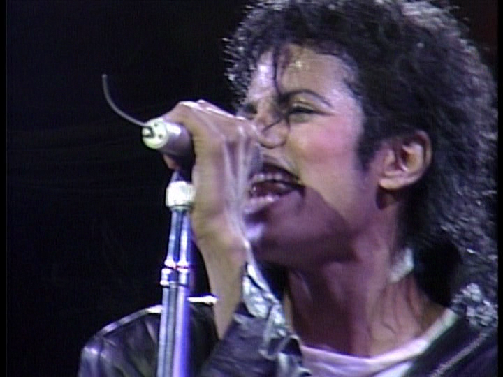

  8. This is the sample. I'm trying to get rid of the noise in the background. I also wanted to get rid of the ghosting/halos, but it's just too hard for me. I'm a noob in this situation. If you have any other ideas, please feel free to say.
    Cheers!

    You can't do very much about the ghost trails, but there are ways to work on the stationary ghosts and halos. Some of that fine-grained "noise" you see appears to be added on purpose. You can always remove it, but you'll have to work pretty hard to avoid the banding that will surely result. The bitrate of the sample VOB was too low to begin with. It appears to be a re-encode from lossy DV (but I'm not certain about the latter).

  10. Originally Posted by sanlyn View Post
    I have no idea how to manage with the ghosts and halos. Regarding the noise, Neat Video will do the job. This is an officially released DVD, sourced from a VHS tape and it makes me cringe when I see all those errors. Can you help me in any way? I can contact you via PM if you need more info...

    It's difficult to conduct a project via PM, and others wouldn't be able to share the answers. RE NeatVideo: there is no frame in the VOB from which one could get a suitable noise sample. Given a good noise sample, NeatVideo will remove most of the fine grain. You could also use one of the MVdegrain versions.
    Halos don't seem to be much of a problem here. The ghost trails are impossible to eliminate. It almost looks as if the ghosts and glowing artifacts on bright specular objects like the mic stand and stage lights were done purposely. Filters don't make ghost trails that look like those in the sample. They're too persistent and don't affect other objects.

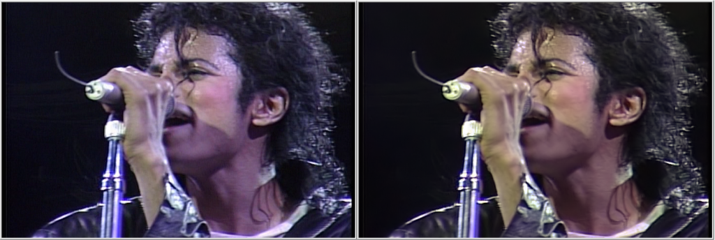

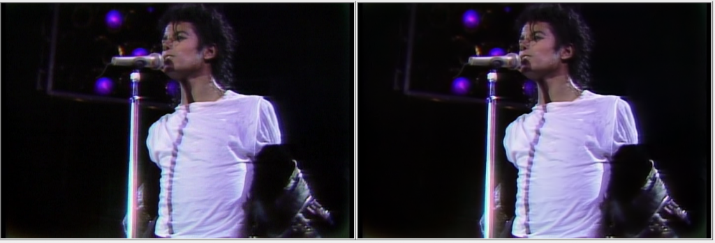

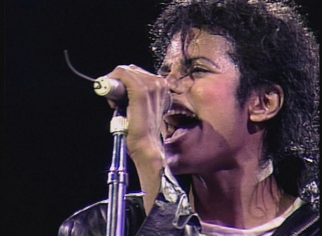

  12. Sadly exorcist can't do much for them ghosts
    After Neating/Deblocking and using one Overlay Mask
  13. RE: ghosts/halos -
    It's going to take quite a bit of semi-manual work to remove those accurately if you want it done well (e.g masks, rotoscoping, motion tracking, compositing).
    This is not something avisynth can do accurately with some "automatic" filter.

    Did you want more explanation ?
    You basically have to manually mask out areas you want to fix. You can speed up the work by using specialized tools that motion track (so you don't have to do it frame by frame)
    That part is not something I would do in avisynth - it's the wrong tool IMO for the halo/ghosts part. There might some things you can do to improve it slightly in avisynth , but the masks generated won't be accurate enough (you will damage other parts, or miss some defects entirely)
    To be clear, I'm talking about multiple edges (e.g. the mike stand, certain times when mj moves) .
    Other things like the blue channel flares can be improved . This is a common issue with many digital cameras, where overbrights lead to one channel clipping differently and early

  18. So what would you recommend to do to the blue channel?
    And what software would you recommend to get rid of the ghosts?
  19. Originally Posted by Dr.Who View Post
    You can probably do that part in avisynth / vdub , maybe with gradation curves . You got to be careful, because only highlight blue is the main problem (you don't want to affect all areas of the channel or you will cause color imbalances) . But you have more control in other programs dedicated for color work
    Just to be clear - you're looking at a lot of manual work if you want to do a good job. Rotoscoping is always the last , last resort because it's the most work. It's not as easy as somefilter() in avisynth. But it is the "last" resort here, because no avisynth method (or other programs even) will accurately isolate the areas you want easily. I would use something like mocha, after effects, or nukex . Probably mocha for roto/tracking combined with AE , because you can do the color work there as well

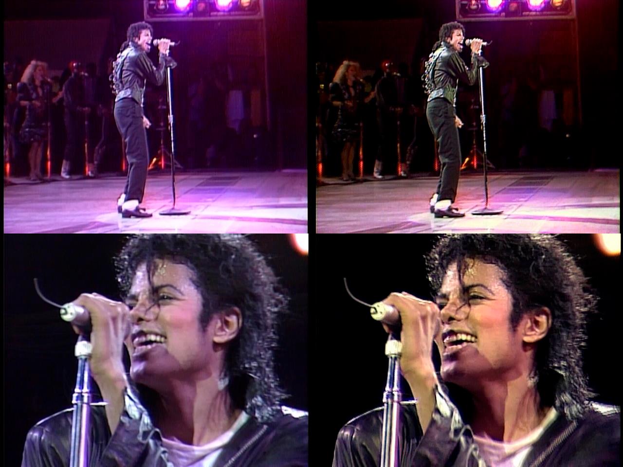

  20. With "gradation curves". Something like this.
    I won't be able to get rid of the ghosts/halos. I will leave it this way,

    I found some snippets of the original masters (claimed by them) of the videos I posted you. Comparison pic:

    Uploading screenshots in original resolution. First the documentary. Second is the released DVD. Third is leaked version.

    Yes. I ripped the DVD on my PC and took the screens with VLC. I'll show you more. This was the BONUS. But as you see it's almost the same as the leaked version. More than that, another bonus was from a U-Matic tape from the archive.

    And now I'll show you a screen from the U-Matic tape and one from the so-called "restored" VHS.
