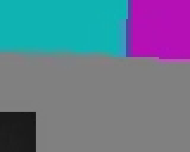

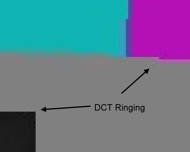

    Originally Posted by SB4 View Post
    Deringing
    Ringing artifacts (8x enlarged, note the small dots):
    After HQDeRing():

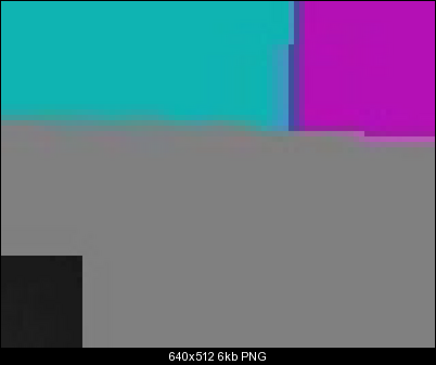

  22. Member
    Jun 2007
    Kuwait
    Hello again
    I have question. In the image below is it need Deblocking, Deringing or just Denoise filter...?!
  23. It needs deblocking. It may need deringing -- it's hard to tell from the subject matter. But since you uploaded a JPG image one can't tell how much of the problems are from the JPG compression and how much was in the original video.
