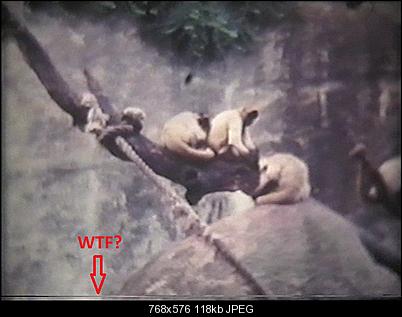

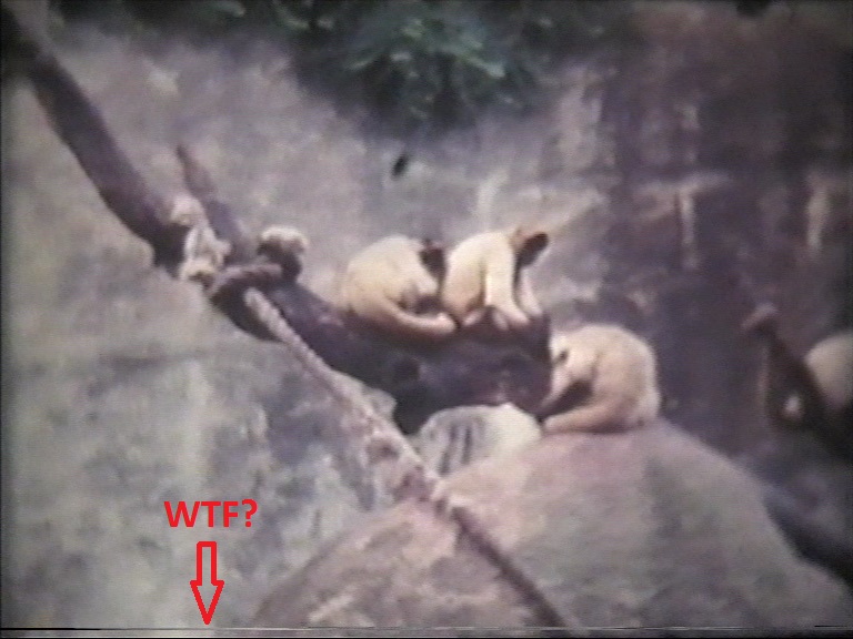

    It looks like the ripoff artists who did your transfer used VHS or another analog tape format as an intermediate step.
    There's nothing wrong with telecine. It's not outdated, at least as far as Hollywood is concerned. It can be applied in several ways. If it's done by setting a flag in the MPEG rather than hard-coding, the clip would physically have fewer frames and would be a smaller file.
    I said telecines, as in the physical machines that Hollywood used before the changeover to film scanners. I wasn't referring to 3:2 pulldown.

    Yes I wondered about that line. Tried the dvd on my hdtv and sdtv there was no line, played on laptop and I see that line, looks a little similar to running the projector in reverse but that cant be the case because when I do that theres no sound. If they used vhs before putting it through onto dvd then I got screwed in like 5 different ways on this lol. They say on their site its a 2 step process, maybe they use vhs as one of the steps .
    Im defently disappointed but they will refund the money next week. So with your guys help I can learn a lot about the proper processes, get a better quality transfer and have a bit of fun with it as a side project. Many thanks.

    Tried MSU deflicker and deflick, not having any luck, the flicker is the same no change for better or worse.
