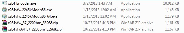

    There are multiple H264/X264/AVC codecs and they do not ALL install correctly or smoothly. Always reboot after trying and see if it is in the compressions to be sure. These are some of the ones I tried:
Name:	ScreenHunter_16 Jul. 31 21.12.jpg
