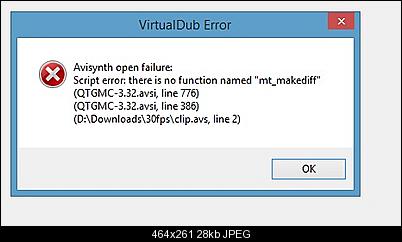

  25. I tried, but I get millions of errors in avisynth

  27. Originally Posted by robsonbyte View Post
    Not a very helpful post. Didn't you read the kinds of information needed so help could be provided, from earlier in the thread? Script? Error messages?
    Or make it 60fps if it isn't already. Or let YouTube decimate it to 30fps for you.
  28. Originally Posted by manono View Post

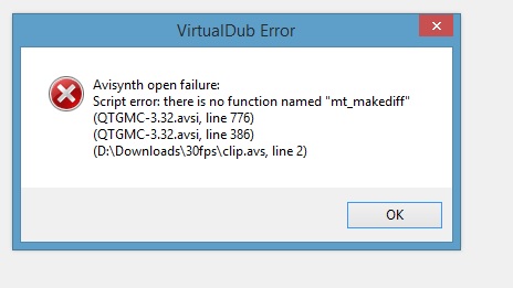

    This is error message. I want to fix stuttering created when I convert 60fps to 30fps, meabe frame dropping too.
  29. Originally Posted by robsonbyte View Post
    Did you install the other DLLs needed for QTGMC to work:
    http://avisynth.nl/index.php/QTGMC
