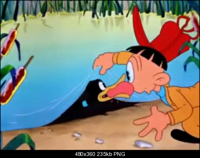

  4. Click image for larger version
Name:	BEEP!  BEEP!.png
ID:	19098Sorry, I'm tired and frustrated. Spend entirely too much time on this stuff.

    I think your audio synch problems are the least of your worries. In that color Betty Boop cartoon, the blacks are crushed and the whites badly blown out. In addition, in every second there are three duplicate frames and what looks to be two missing frames (maybe, hard to tell). They've been converted from film to PAL and maybe your sources were already like that, and also look overfiltered. And maybe not and it can be done properly. It also looks to me like they were badly deinterlaced. I don't know how you've 'remastered' these things, but there's room for lots of improvement. A ten-second untouched sample from the 'source' might be helpful

    >>>>>In that color Betty Boop cartoon, the blacks are crushed and the whites badly blown out>>>
    Just what do you mean??
    If you could give me an idea of what to do, I will buy you dinner the next time we meet. Hope you like hamburgers or hot dogs. Coffee??
    Any guidance will be deeply appreciated. Even as to what program would be best to use, what format they should be in and how to set up the filtering.
    I thank you from the bottom of my black pitted heart. andythebeagle thanks you too. He's getting tired of laying on my lap and getting a head ache from watching me and the mess I create. Just glad I have the choice to delete bad stuff.
  18. >>>>>In that color Betty Boop cartoon, the blacks are crushed and the whites badly blown out>>>
    Luminance levels fall within a certain range of values. If you alter luminance in some way and the usual range of values is exceeded, the effect can be for dark greys to become black or for whites to be "clipped" (for want of a better word). That sort of thing.
    It may be that your source videos aren't good quality and the sample you posted wasn't the result of anything you did. I've seen DVDs in the past which were pretty terrible, and I'm even certain I've seen DVDs which were mastered using the wrong range of levels.... The PAL DVDs of Battlestar Galactica come to mind. There's a couple of episodes from season three which look washed out. Even the opening titles look different. Space is dark grey, not black.
    Anyway, normally you'd re-encode video "as-is" and not need to think about levels. What comes out is the same as what went in. The other stuff manono mentioned... missing frames, bad de-interlacing, over-filtering of some sort etc..... that can all happen when re-encoding, or you could be re-encoding video which had already been badly re-encoded in the first place and there's not much you can do to fix it. Sometimes encoding GUIs with automatic settings for that sort of thing can get it wrong and make a bit of a mess. Hence the suggestion to post a short sample of the source video.
    I see that the toon I sent along has some issues with the loop filtering, deblocking, as they ended up being overly soft instead of having crisp edges like drawings should have.
    Are you using Handbrake's de-noising filter? I don't use Handbrake myself so I don't know a lot about it (what noise filtering it uses), but noise filtering is generally some sort of compromise between removing noise and blurring the picture a little. If you're using denoising, chances are the stronger the denoising the more potential for blurring there is.

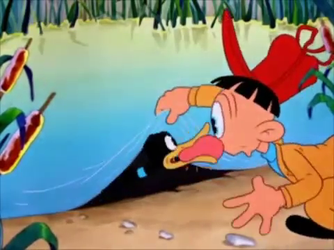

  20. I think this is the original. Found I've several copies of this. Too cluttered.

  22. I took a long look at all of the source videos I have for this one and all are worse that the one I did here. I found that I have 20 some copies of this. Most were on old hard drives I was given. I really gotta clean this mess up. I had the suspicion that constant re formatting and compression would ruin them. You're right in saying the first original had to be good. Once you take the same one and distribute it all around over and over, you're not left with much. These videos have a terrible pedigree. There are very few if any original film stock left and even those are suffering from the deterioration of celluloid rot.
