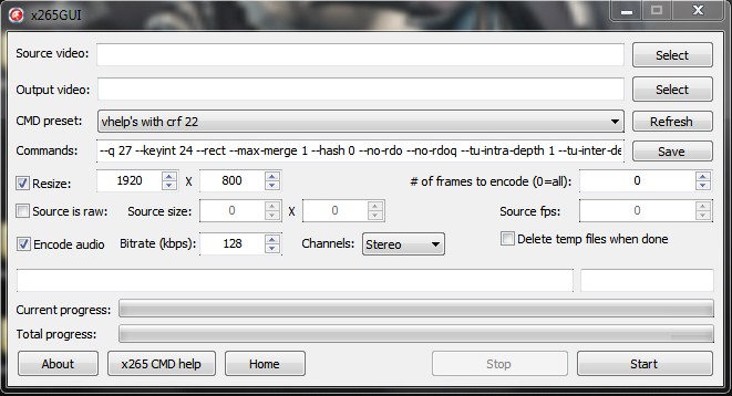

  9. Member ozok's Avatar
    Oct 2011
    Turkey
    I managed to get my GUI to pre-alpha status. You can download it from https://bitbucket.org/ozok/x265gui (9 mb)
    Package includes x265.exe, ffmpeg.exe, mp4box and GUI. First select source file. It can be raw but you must select "Source is raw" and specify its properties. Otherwise, source will be converted to yuv. Then if you selected to encode audio it will encode audio to aac. As next step it will mux them to mp4 and delete temp files if you selected this too.
    As I said earlier, I'm not familiar with x265's options, so I sorta added a "preset" system where user enters his/her commands and saves these commands as presets to use them later. So, if you think you have x265 command line options, I can add them for everyone's usage.
    There is probably a huge number of bugs, so bug reports and suggestions are welcome.
    And thats how it looks:
    https://forum.videohelp.com/images/imgfiles/tQXNSmc.png

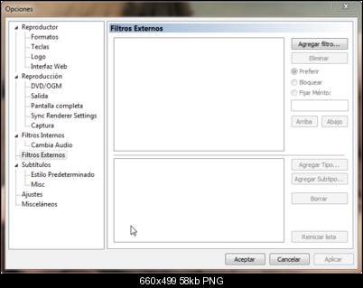

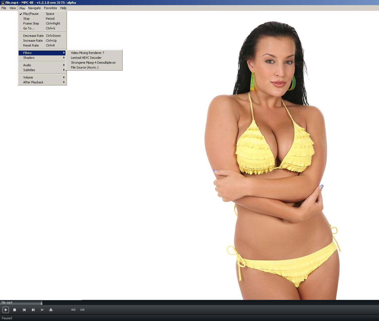

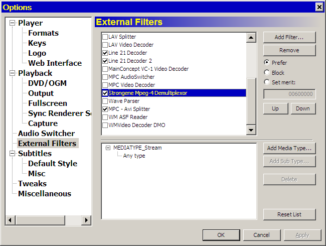

    Originally Posted by ozok View Post
    @el heggunte I tried as you suggested and muxed raw h265 stream to mp4 container. How do I play this file? I couldn't play it graphstudio but I can play raw file with graphstudio using Lentoid decoder. And I don't know how to configure other players (MPC-HC for instance).
    Hey people, please start paying MORE ATTENTION !!
    Originally Posted by El Heggunte View Post
    [!-- SNIPP --]
    Anyway, now I have the most recent "nightly" MP4Box, and after remuxing a test video, I could play it in Graphstudio with the help from Strongene MPEG-4 Demultiplexor (mp4demux.dll)
    http://xhevc.com/en/downloads/downloadCenter.jsp

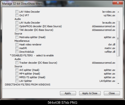

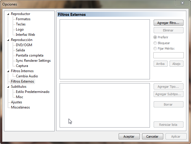

    Jul 2013
    Spain
    I have nothing...
  16. DECEASED
    Jun 2009
    Heaven
    ^ YMMV
    @ vhelp again: you just must be sure that the right filters are being used at the right time.
    Nov 2002
    Originally Posted by Trepack View Post
    I have nothing either but if you've installed the newest Strongene decoder then it should automatically use it when you try to play the file since it is registered in your system. If you've installed the newest decoder and it doesn't automatically load when you try and play the mp4 (or hm10) then I assume you can load it manually in the box you showed.
    Sorry, multiplexor

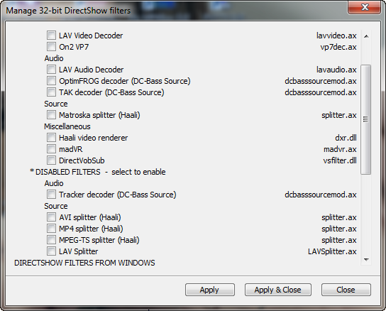

  19. DECEASED
    Jun 2009
    Heaven
    LAV Splitter, AV Splitter and Haali Media Splitter actually are SETS (or "suites") of demuxers.
    However there is no such thing as a "perfect" or *comprehensive* demuxer
    Currently the MP4 and FLV demuxers of LAV and AV do connect to a source file that contains HEVC, but they're unable to connect to the Lentoid HEVC decoder Therefore, if you use an advanced player like MPC-HC or PotPlayer,
    you can use the Strongene demuxers only when you need them,
    instead of disabling the MP4 or FLV demuxer in the AV/LAV splitter "forever".

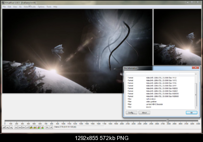

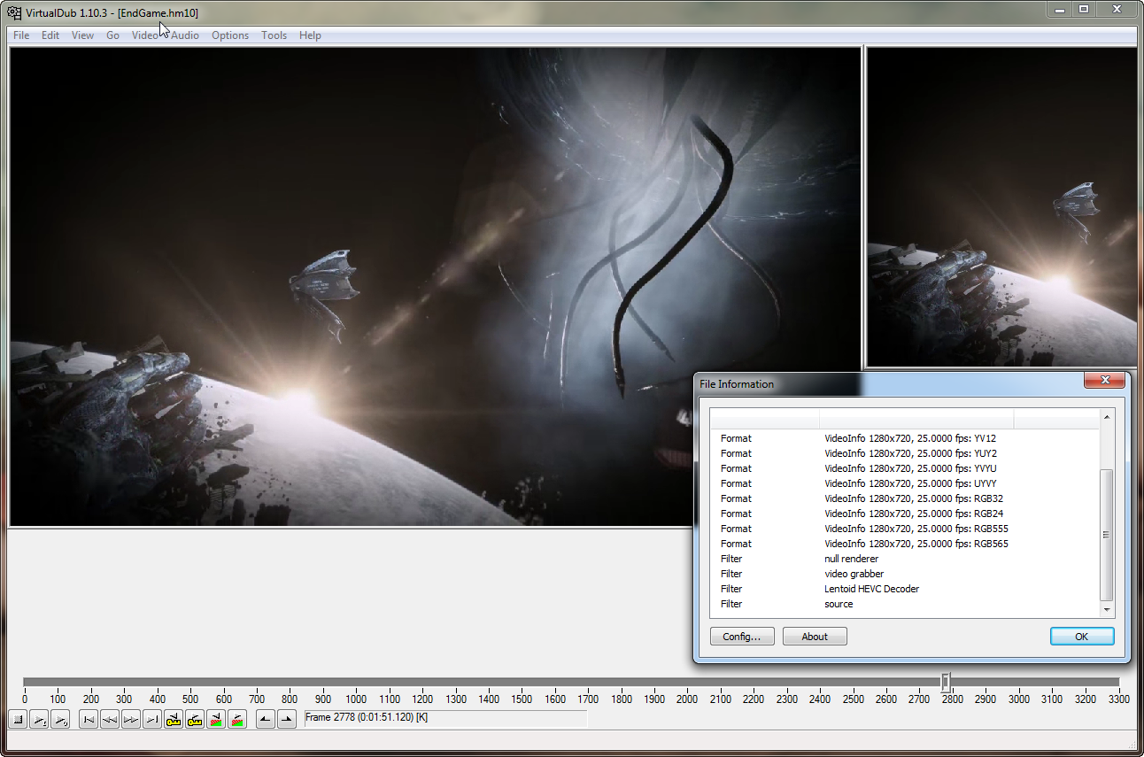

    Nov 2002
    I installed the latest Lentoid decoder with the mp4demux.dll and the needed files are automatically loaded in mpc-hc. If I load an mp4 without x265 then the correct files are loaded to play that mp4.

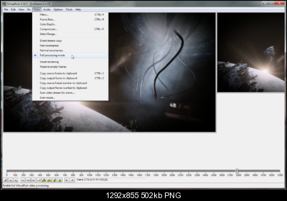

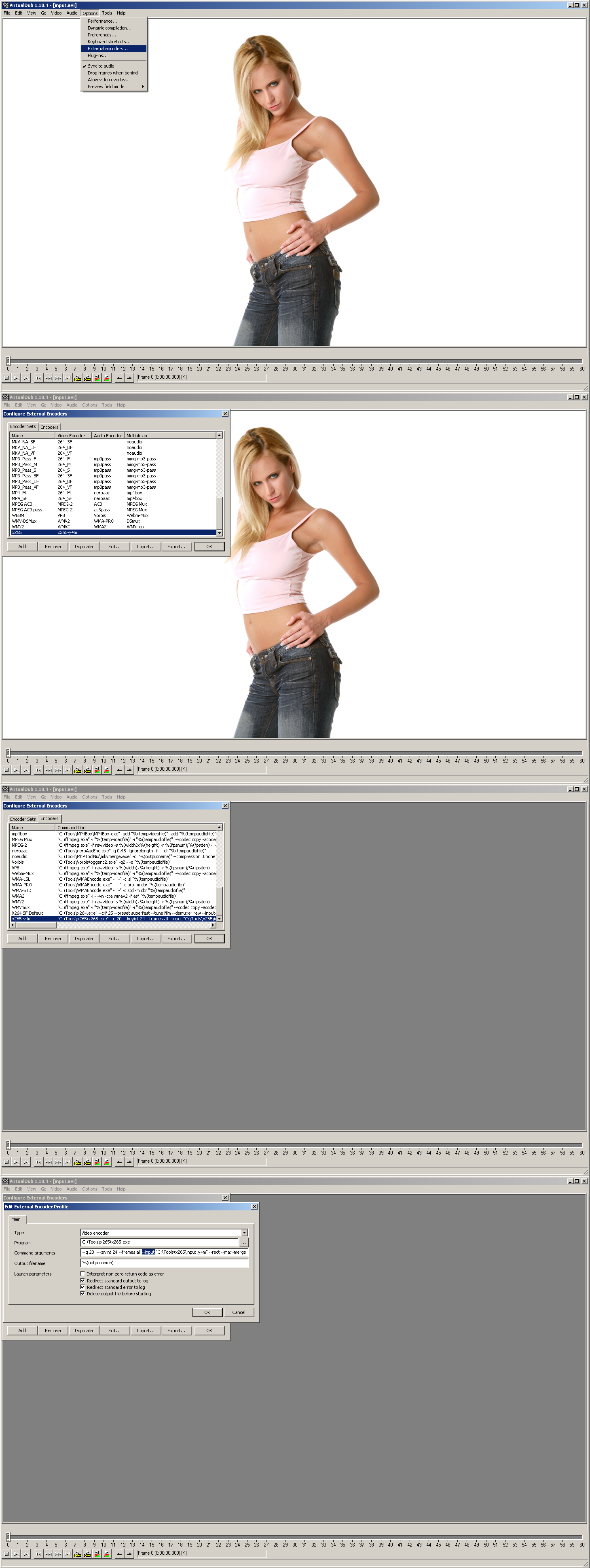

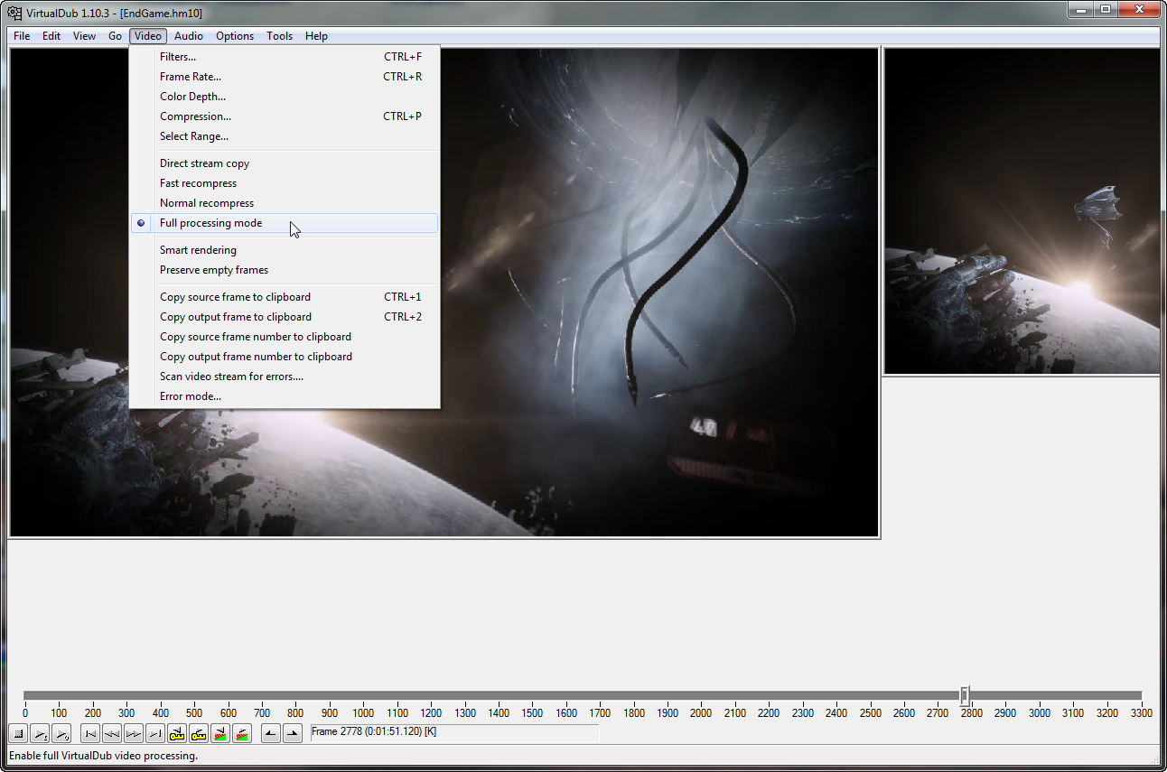

  25. Member
    Nov 2002
    We can open hm10 in Virtualdub. What I need is an option to open with stdin through pipe... "-"
    EXAMPLES:
    aften.exe -b 192 - "%(tempaudiofile)"
    Cuda.exe --resolution %(width)x%(height) --input - --sar 1x1 --format IYUV --control_mode cbr --bitrate 2000 --bitrate_peak 50000 --fps %(fps) --profile high --level 41 --offload partial --measure FPS --showFrameStats 100 --deinterlace false --frame_typ frame --pframe_dist 1 --gop_max 250 --dynamicGOP true --pquant_min 18 --bquant_min 20 --iquant_min 16 --deblock true --cavlc false --nal_typ auto --sps_pps false --slices auto --output "%(tempvideofile)"
    fdkaac.exe --bitrate-mode 0 -o "%(tempaudiofile)" --raw
    ffmpeg.exe -f rawvideo -s %(width)x%(height) -r %(fpsnum)/%(fpsden) -i - -vcodec mpeg2video -target ntsc-dvd "%(tempvideofile)"
    lame.exe -V6 - "%(tempaudiofile)"
    mencoder.exe -demuxer rawvideo -rawvideo w=%(width):h=%(height):fps=%(fps) - -ovc x264 -x264encopts bitrate=3000 pass=1 nr=2000 -o %(outputname).mp4
    neroAacEnc.exe -q 0.45 -ignorelength -if - -of "%(tempaudiofile)"
    oggenc2.exe -q2 - -o "%(tempaudiofile)"
    WMAEncode.exe -i "-" -c pro -m cbr "%(tempaudiofile)"
    x264 --crf 21 --preset faster --tune film --demuxer raw --input-csp i420 --input-res %(width)x%(height) --fps %(fpsnum)/%(fpsden)-o "%(tempvideofile)" -
