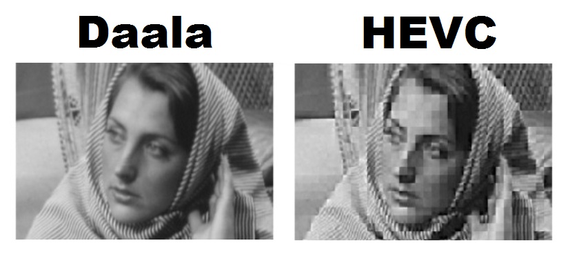

    The first image shows how large blocks 64 instead positive demonstrates detrimental effect (stairs instead of the horse's legs).
    Developers on this project Daala predicted losing HEVC (impasse).
    They went on a promising / innovative thorny path of development (not to step on a rake).

    What happens on the first picture ... I have already raised this issue And suspicions lead to:
    1. Smoothing pushes pixels (located on the edge of the block) outside of the block. The lower bits in the block, the greater the likelihood that the edge pixels will fall out.
    - This is the direction you need to do to improve (try to keep the extreme / corner pixels).
    2. After smoothing in the block edge pixels fall on the neighboring block (become a foreign body); Strips of wood.
    - It's interesting.
