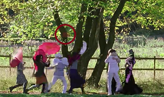

    Earlier I wrote about the remark of contact with pieces of frames from the following frames > Slices of the future
    - Similar description for the codec VP9 > @zerowalker ("green pig" )

    In general, it is not wrong for B frames to have slices with references to future P or I frames. That's exactly the purpose of B frames: To optimize size by referencing most similar sources with bidirectional prediction. So I wonder why you are complaining about what is a feature on purpose ... except it goes wrong in a way that it introduces annoying compression artefacts, then it would be a bug to be fixed.
    __
    So this is a problem in my settings or it is a feature of x265 crooked build frames?

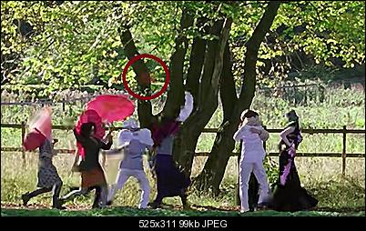

    x265 1.3+185-2fb61cc75152 - also not the right construction;
    frame №87 (B) - shows a part of the umbrella comes from future frames.
    Original sample > park_joy (mega.co.nz).

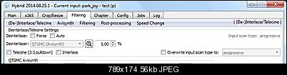

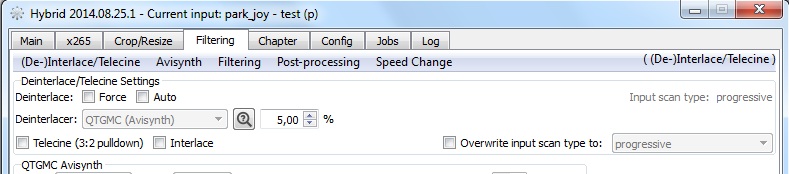

    But it makes me wonder if the original video already has interlacing or blending.
    I always turn off the deinterlace mode: Auto (to encode a bit faster).
