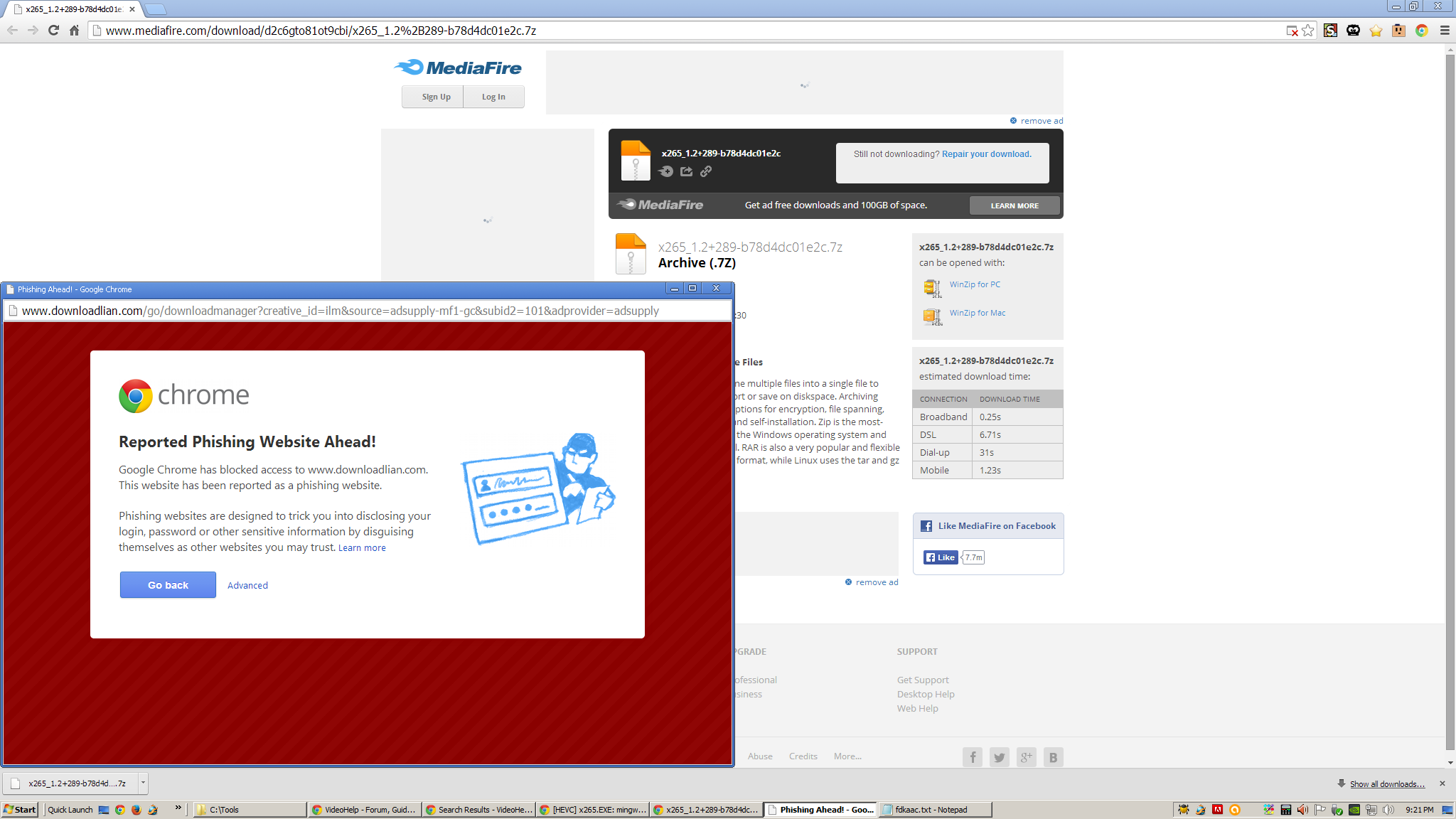

    So there is x265 1.2+289-b78d4dc01e2c with exposed 2-pass CLI parameters. Issues with VBV are known. There is no "turbo 1st pass" yet.
    Is there any way that you can post your builds on VideoHelp instead of Mediafire which has been known to be an untrusted website since I bought my first computer back in 2000?

    Nov 2002
    Originally Posted by El Heggunte View Post
    ^ STOP using Chrome , problem solved
    Seriously, man, Google has been very-good at giving us false alarms.
    And its very-first product, the search engine, keeps sucking more and more each day -_-
    Chrome has been safer for me than Firefox. I use Chrome for my trusted sites and use Firefox with scripting and cookies turned off for other sites. I have two gmail addresses. One is my ISP email which I only give to certain people and the other is for everyone else incase I get spammed which is very rare for me nowadays. Facebook and youtube both are run by Google so it makes sense for me to use Chrome as my browser.
    BTW, the last warning I got before the one above was from Avast. Pop ups are bad enough but when sites go to the trouble of using pop unders where users aren't aware that there is another page under the one they're viewing then that site can not be trusted.

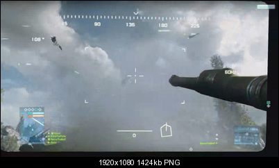

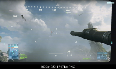

  15. Image quality of video using x265 1.1+88 is much worse than 1.1+45, do not know what the problem is (I’m useing Google translation )
    See pictures(abr 2048k preset medium)
    x265 1.1+45
    x265 1.1+88
  16. @staging area: use the latest version, both versions you mentioned are quite old
  17. DECEASED
    Jun 2009
    Heaven
    Exactly, use a build as recent as this one
    commit a967898 == rc: fix crash in 2 pass for faster preset (ultrafast - faster)
  18. I failed in 1.2+366,so i could just use 1.2+305,The quality doesn't seem as good as 1.1+45
    [Attachment 26653 - Click to enlarge]
    1.2+305
    origin

  26. 1.2+305
    I tried
    [program --bitrate 2048 --frame-threads 2 --b-adapt 0 --output "output" "input"]
    and
    [program --bitrate 2048 --frame-threads 2 --bframes 0 --output "output" "input"]
    both have the same quality as 1.1+45

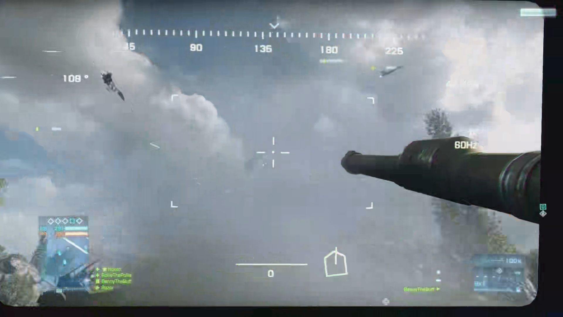

    Used x265_1.2+366-a9678988dda2 (x64) - In the frames get slices of the future.
    Original sample > park_joy (mega.co.nz).
  28. In the frames get slices of the future.
    b-frame = bi-directional frame
    => it's ment to have references to upcoming and previous frames inside a GOP, that's why coding and preview order are different things,....
    Either I totally don't get what you want, or you should read up on how MPEG compression in general works and what the difference between the individual frame types is.
  29. Member
    Jan 2014
    Kazakhstan
    In the frame № 91 (B) got a slice of the frame № 99 (B).
  30. And? As long as they are both in the same GOP that's normal, Frame number 99 might even have references to frame number 91. (b-pyramid allows b-frames to reference other b-frames otherwise b-frames are not allowed to reference other b-frames iirc.)
    a. Coding and display order are different things!
    b. b-frames are ment to have references into the past and future (when looking at the display order)
