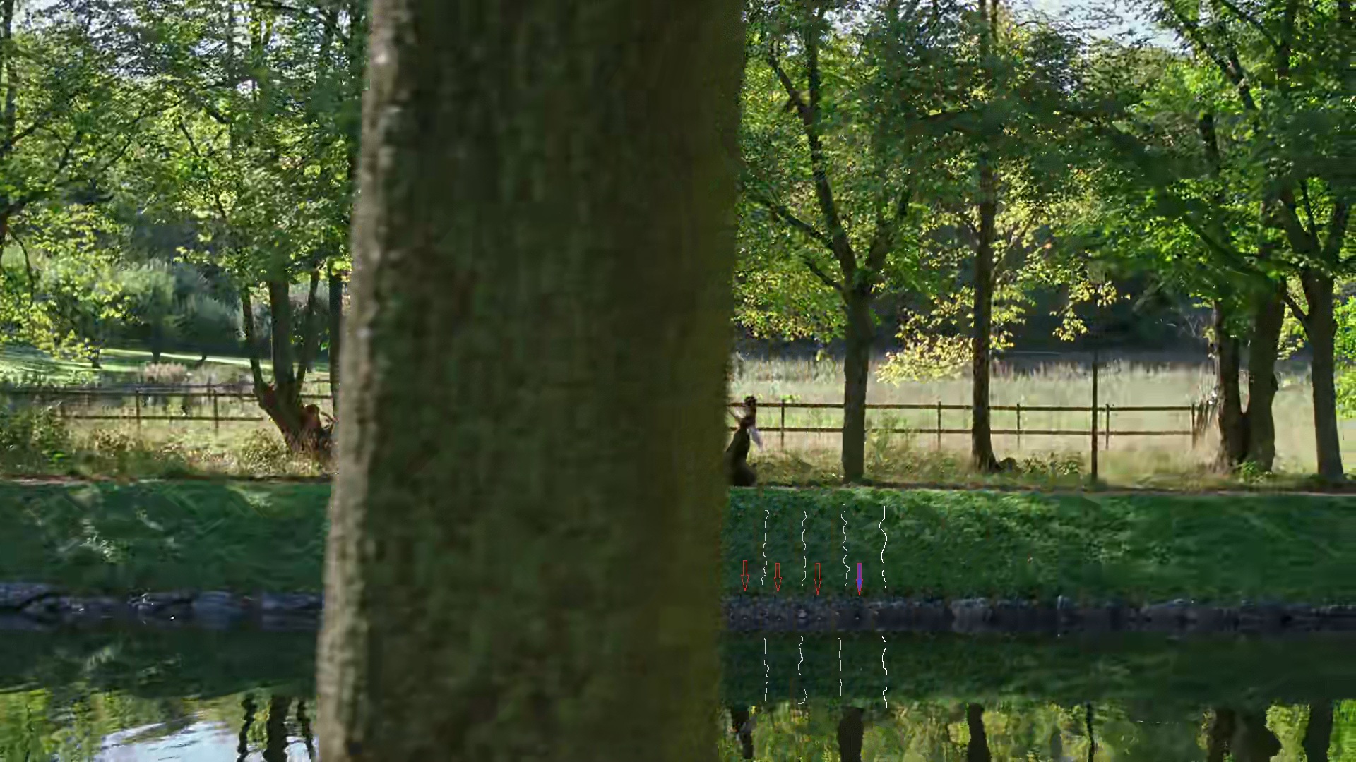

    "C:\PROGRA~1\Hybrid\x265.exe" --tune ssim --preset slower --input - --input-res 1920x1080 --fps 50 --frames 19 --max-merge 5 --no-strong-intra-smoothing --weightb --b-adapt 1 --bitrate 2000 --psy-rd 0.5 --aq-mode 1 --no-cutree --sao-lcu-bounds 1 --colormatrix bt709 --output "C:\Users\PARADO~1\AppData\Local\Temp\x265_11_11_3 4_6710_01.265"
    x265 [info]: HEVC encoder version 1.1+45-e5656f1e1904
    x265 [info]: build info [Windows][ICC 1400][64 bit] 8bpp
    x265 [info]: using cpu capabilities: MMX2 SSE2Fast SSSE3 Cache64
    x265 [info]: WPP streams / pool / frames : 17 / 2 / 1
    x265 [info]: Main profile, Level-4.1 (Main tier)
    x265 [info]: CU size : 64
    x265 [info]: Max RQT depth inter / intra : 2 / 2
    x265 [info]: ME / range / subpel / merge : star / 57 / 3 / 5
    x265 [info]: Keyframe min / max / scenecut : 25 / 250 / 40
    x265 [info]: Lookahead / bframes / badapt : 30 / 8 / 1
    x265 [info]: b-pyramid / weightp / weightb / refs: 1 / 1 / 1 / 3
    x265 [info]: Rate Control / AQ-Strength / CUTree : ABR-2000 kbps / 1.0 / 0
    x265 [info]: tools: rect amp rd=6 psy-rd=0.5 lft sao-lcu signhide
    encoded 19 frames in 95.49s (0.20 fps), 2098.84 kb/s
    x265 [info]: frame I: 1 Avg QP:44.83 kb/s: 5971.60
    x265 [info]: frame P: 9 Avg QP:42.19 kb/s: 3493.07
    x265 [info]: frame B: 9 Avg QP:44.60 kb/s: 274.31
    x265 [info]: global : 19 Avg QP:43.47 kb/s: 2098.84
    x265 [info]: Weighted P-Frames: Y:0.0% UV:0.0%
    x265 [info]: Weighted B-Frames: Y:0.0% UV:0.0%
    x265 [info]: consecutive B-frames: 10.0% 90.0% 0.0% 0.0% 0.0% 0.0% 0.0% 0.0% 0.0%
    finished after 00:01:35.721

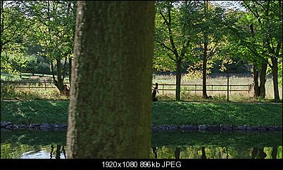

    Overlooked
    Strip from the trees show that the encoder does not produce image correction with the next frame - stupid duplicates / not refer to changes (not subtracts).
    My suspicions seem to come true:
    > theory 1
    > theory 2
    Also > DivX
    Original
    x265
  29. @Graviator: don't use psy-rd, it's known to produce artifacts
  30. Member
    Jan 2014
    Kazakhstan
    This is a clear example of the demonstration not only of psy, and also for the entire encodings! You will not be able to get rid of bands without awareness of this problem. - What do I disable or enable to the strip from trees gone?
