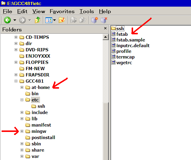

  9. DECEASED
    Jun 2009
    Heaven
    Originally Posted by vhelp View Post
    ... has anyone put up a guide on how to compile on their own, x265.exe ?
    0) Download and unpack one of the "full Msys+MinGW packages" from Xhmikosr's site:
    http://xhmikosr.1f0.de/tools/
    or
    http://xhmikosr.1f0.de/tools/old/
    1) Edit the file etc\fstab --- for example,
    #You can use a # as the first character on the line as a comment indicator.
    #Blank lines are ignored.
    #Win32_Path		Mount_Point
    E:/GCC481/mingw         /mingw
    E:/GCC481/at-home       /home
    #fstab.sample
    #This is a sample file for /etc/fstab.
    #Currently /etc/fstab is only read during dll initialization.
    #I will eventually watch the directory for changes and reread the file.
    #The line format is simple in that you give the Win32 path, followed by one or
    #more space or tab delimiter, followed by the mount point.  Mount points in
    #typical UNIX environments must be a physical name on a drive before it can
    #actually be used as a mount point.  In this implementation the "must exist"
    #requirement isn't enforced, however, it will be an aide to such programs as
    #find and readline's tab completion if it does exist.
    2) install (or rather, *unpack*) both CMake and Mercurial to their respective folders. Make sure that "Path-To\CMake\bin" and "Path-To\Mercurial" were added the PATH environment-variable --- if they weren't, then do it manually.
    3) Create the folder where you want to store the x265 source-code.
    4) Open a command prompt on that folder.
    5) Type and enter this command-line: hg clone https://bitbucket.org/multicoreware/x265
    6) After the download is complete, type msys and press Enter.
    7) Change the working directory to "Path-To/x265/build/msys".
    8) Run cmake -G "MSYS Makefiles" ../../source && cmake-gui ../../source
    9) IGNORE the warning about the stupid Visual Leak Detector thing.
    9.5) Or you can edit the main CMakeLists.txt and erase the lines about the Visual Leak detector.
    10) In the CMake GUI, click the buttons "Configure" and "Generate".
    11) Back in the Msys console, run make.
    12) IF the compiling process manages to reach 100%, THEN type exit, and go test your newborn x265.exe.
    13) Otherwise, copy the compiling error message and send it in an e-mail to Steve Borho.
    [ steve ättt borho d0ttttt org ]
    HOW TO BUILD 64-BIT BINARIES:
    https://forum.videohelp.com/threads/357754-%5BHEVC%5D-x265-EXE-mingw-builds?p=2301105&v...=1#post2301105

  12. Member vhelp's Avatar
    Mar 2001
    New York
    i was not able to compile. i am just not unix savy person, its another world to me. i got stuck on step 1 have no idea what it means. i just want to get it all installed? onto a memeory stick and run it from there, on any computer or netbook or laptop. if someone could create a complete memory stick version, that would be awsome!!
    i'm also working on a gui for x265 and ffmpeg (libx265) though lib265 still does not seem to work, so is worthless for now. however, if others want to code one up for any/both and post, that is good too. but please make it drag/drop convenient. i just want to d/d my source into it, (give the input source spec details, x,y, rate, a quick basic param string tempate (so nothing is entered) etc) and encode. otherwise, do what you feel sutes you.
    not sure if all would agree, but if we need to compare against something, lets use the strongene lentoid hevc encoder as a base and compare x265 revisions (encodings) to it for the time being.
    and if someone is savy enough, (i've seen many topics here on watermark/logs etc) to take the watermark from the strongene lentoid encoder and create a new one that we can import into an avisynth script to incorporate into (same x,y position) when we create our raw yuv source to encode form, the watermark will be in the same place as strongene lentoid's. then we can compare the two. the reason i suggest theirs is because it is the simplest to setup and encode with, i was not able to get the other two competiter hevc encoders to work. post the method / steps so all can use.
    Jul 2013
    Spain
    Edit...
    Jul 2013
    Spain
    Up-to-date whit commits 83def50
    x265 version 0.3+236-83def5041252--GCC_4.8.1
    Regards
    i got stuck on step 1, I have no idea what it means.
  16. Member vhelp's Avatar
    Mar 2001
    New York
    this is the archive i d/l'ed to my mem stick, and then used 7z's copy-to function to the mem stick as g:\tools drive
    "MSYS_MinGW-w64_GCC_481_x86-x64_Full.7z"
    etc\fstab and at-home folders do not exist in the created folders. i did see a etc\fstab.sample file though. i did not run any install or other program. just copied everything over via 7z. i will look again at it when i get home. its my pizza night, fridays..
    edit: wait, i have the mem stick with me..give me a moment..
    Jul 2013
    Spain
    Edit your fstab.sample and save it as fstab well
    g:/tools/MSYS/mingw    /mingw
    g:/tools/MSYS/home    /home
  18. Member vhelp's Avatar
    Mar 2001
    New York
    in the image i posted of the folder, there is no ../home folder
    maybe "MSYS_MinGW-w64_GCC_481_x86-x64_Full.7z" is incomplete ? .. doesn't have all the folders ?
    Jul 2013
    Spain
    When you create the file fstab a run msys.bat your home directory is created...
    And will be in your user folder Inside you'll of this you can put the x265 directory if you want or run in terminal...
    If you already have Mercurial
    if you want to know if there are changes in the code run
    cd x265
    hg pull
    if any will be seen in the terminal and will only have to run
    hg update
  20. Member vhelp's Avatar
    Mar 2001
    New York
    ok, i made the change in file 'fstab.sample' and saved as 'fstab' with the following:
    #c:/mingw               /mingw
    #c:/ActiveState/perl    /perl
    g:/tools/MYSYS/mingw    /mingw
    g:/tools/MYSYS/home     /home
    Jul 2013
    Spain
    #c:/mingw               /mingw
    Ok compile test if you already have Mercurial or Tortoisehg and the source code downloaded
    cd x265/build/msys
    In the CMake GUI, click the buttons "Configure" and "Generate" close it when finished and run...
    make
    when finished go into x265/build/msys directory and the file x265.exe will be within,should if everything was fine
