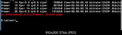

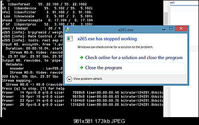

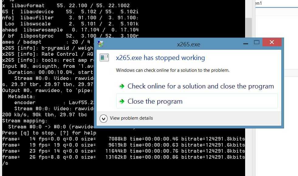

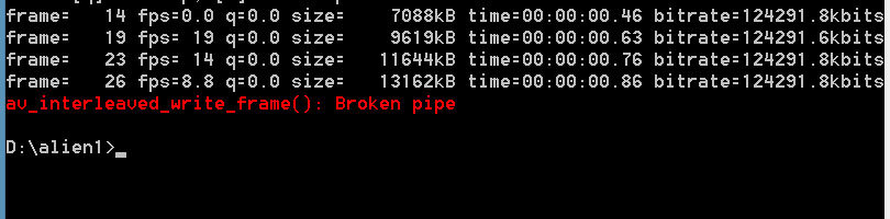

  20. Hi everybody. Help please, trying encoding but start from version 0.7 x265 stoped encoding. Try with ffmpeg pipe to x265 versions took from here x265.ru and try all versions that works on my system Windows 8 32bit. From here http://chromashift.org/x265_builds/ http://builds.x265.eu/ commandline wrote that this version of OS don't accepted. What I can do?
    Aug 2013
    Central Germany
    Could you please quote the exact error message? Did you possibly try to run a 64-bit x265 on a 32-bit Windows 8?
  22. Click image for larger version
ID:	24276Click image for larger version
    This is on all version from 0.7 Try build 0.4 everything fine. My system Windows 8 32bit.
    My commandline. I try different, but even on this simple the same problem.
    cmd /s /c ffmpeg -i 1.avs -s 720x480 -r 29.97 -f rawvideo - | x265.exe --input-res 720x480 --fps 29.970 --bitrate 450 --output "video.hm10" --input -

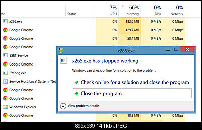

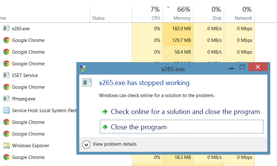

  23. seeing that you use a 32bit System, Avisynth and x265 you might want to have an eye on your memory consumption, might be that you run out of memory,...
  24. Click image for larger version
    How to check this? how I can see it even don't get to max and just breakout. And swap file set in automatic mode.
    I tryid encode file to avi, and then put from ffmpeg to x265 and the same problem.
  25. Swap file only helps if a single application is not using more than 2GB RAM.
    I attached up-do-date 32bit statically compiled x265 version 0.8+233 x265. (compiled with MinGW)
    try if those work
  26. No the same problem at 20-40 frames process stops.
