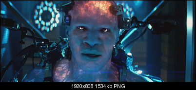

    this sample is not suitable for presentation quality (obviously a poor source\8bit)

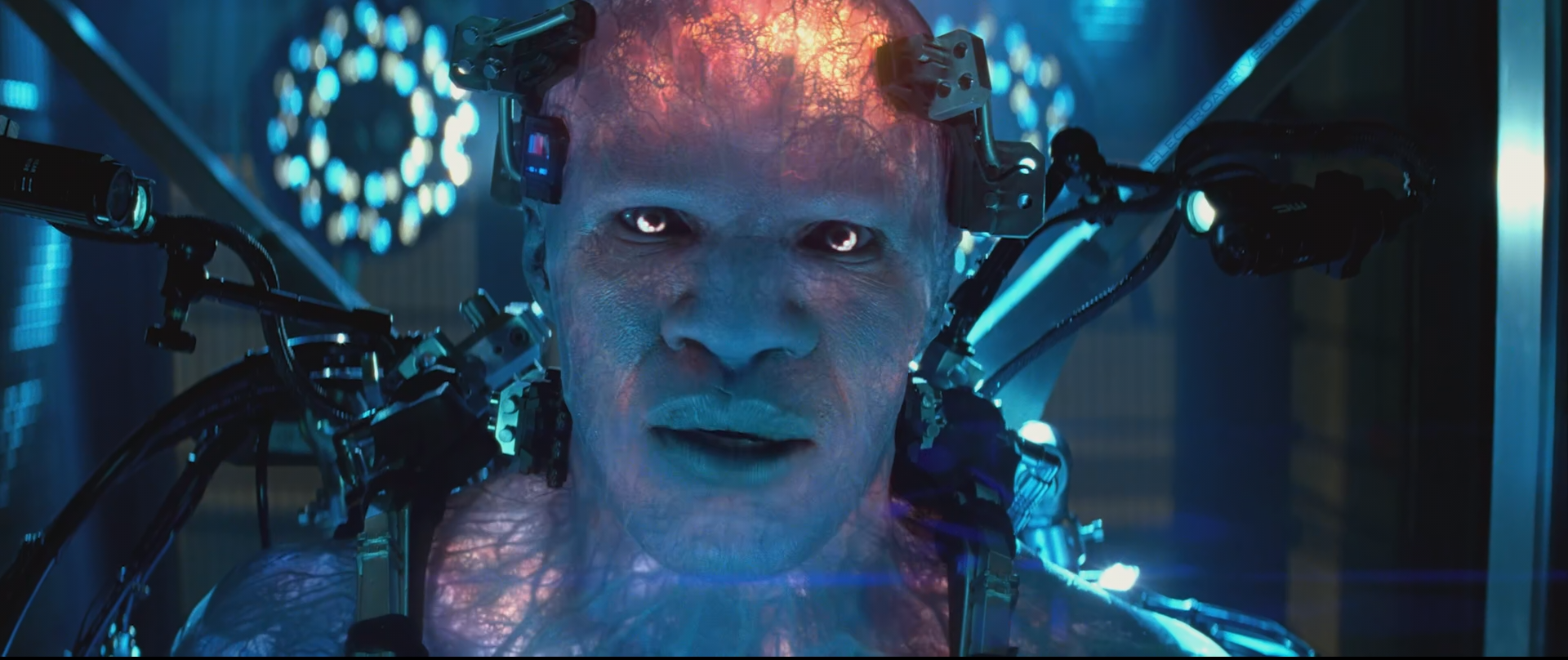

    Conversion - prometheus(black)(1).ts - Preset Fast - Rate Control= ABR + or - 1.500kbps - (Mutant) H265-Hevc/Divx-10bits
    Works on DivxPlayer, MPC-BE, VLCPlayer, KMPlayer, PotPlayer and others - 3,74 MB

    Screen:

    Thank you Marchand;
    You have not right player is set to output (0-255, 16-235); judging by the screenshots.
    In general, I am satisfied
    Output madVR yet smears texture in full screen mode (looking at the problem) - probably influence the graphics driver ...
