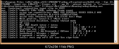

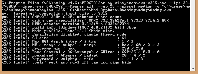

  1. I tried both under windows 8 and 8.1 64 bit.
    I tried also several builds of x265.exe, all of them crashed.
    Here is a shot Click image for larger version
    I tried with CBR or QP, same result.
  2. have you tried using x265 without avs4x265?
  3. Yes, and I had the same crashes at the same moment in the process.
    My UAC is off. I tried several video sources with different video codecs and/or containers, always the same problem.
    I have no problem encoding into Xvid, x264 or anything else, the problem is ONLY with x265.
