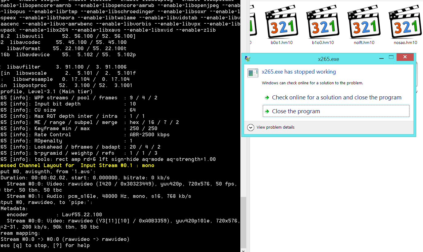

  4. Hi, after build 0.6+ rev 31 when trying to encode in 10bit, x265 crash. Trying all different builds, but nothing works. Trying encode without pipe and leave in commandline only bitrate and --preset ultrafast the same problem. Can someone tell what to do with this or how to tell developres about this bug.

  5. Trying all different builds, but nothing works.
    works fine here using:
    x265 [info]: HEVC encoder version 0.6+112-ef26367cd10c
    x265 [info]: build info [Windows][GCC 4.8.2][64 bit] 16bpp
    x265 [info]: using cpu capabilities: MMX2 SSE SSE2Fast SSSE3 SSE4.2
    and:
    ffmpeg -v -10 -i "H:\TestClips&Co\test.avi" -an -sn -threads 8 -vsync 0 -r 25 -pix_fmt yuv420p10le -f rawvideo - | x265-16bit --preset ultrafast --input - --input-depth 10 --input-res 640x352 --fps 25 --frames 429 --output "H:\Output\test_09_22_43_4510_02.265"
    or
    ffmpeg -v -10 -i "H:\TestClips&Co\test.avi" -an -sn -threads 8 -vsync 0 -r 25 -pix_fmt yuv420p -f rawvideo - | x265-16bit --input - --input-res 640x352 --fps 25 --frames 429 --output "H:\Output\test_09_30_34_1210_02.265"
    attached the x265 version I used.
    only real chance is to post on the developer mailinglist (the bug tracker on their side is just for 'show' and like it seems, not being monitored at all)
  6. Normal release.
    I fixed a bug x265 crash 10-bit in the source code. Site where I post their jobs assembly.
    http://x265.ru
    http://machine-doll.ru/vc13/
