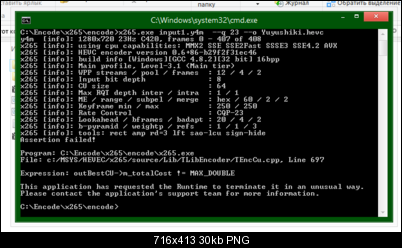

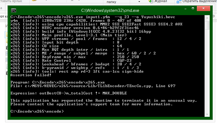

  28. After compiling. New build x265 falls.
    And the question is where the settings before compiling x265? And how to build a 64-bit version on GCC?
    Because in their cmake not even almost.

    @Fllear:
    in the CMake GUI, before "configuring" and "generating", tick the checkbox "treat warnings as errors".
    Later, copy the compiler error message, and send it to the x265 mailing list.
  30. Originally Posted by El Heggunte View Post
    @Fllear:
    I asked the question how to fix or where to send it!
    I asked how to configure compilation. Ie how to compile a 64-bit version and more. When compiling via MinGW, cmake settings in almost all present.
