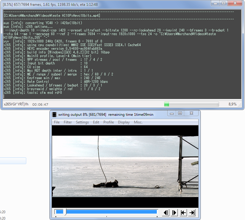

    encoder (x265.exe):
    rev 0.5+617-833d78aaf71e (UTC 12:19:03 PM)
    Completed conversion ( Sample input-H264 Hi10p with outlet Hevc.H265 Main10 profile, Level-4 (Main tier) running normally )
    [C:\Users\Marchand\Videos\teste HI10PxHevc10bits.mp4]
    auo [info]: converting YC48 -> i420p(10bit)
    auo [info]: x265 options...
    --input-depth 10 --input-csp i420 --preset ultrafast --bitrate 1200 --rc-lookahead 20 --keyint 240 --bframes 3 --b-adapt 1
    --ctu 64 --me 1 --merange 60 --ref 2 --frames 7694 --input-res 1920x1080 --fps 24 -o "C:\Users\Marchand\Videos\teste
    HI10PxHevc10bits.265" "-"
    yuv [info]: 1920x1080 24Hz C420, frames 0 - 7693 of 0
    x265 [info]: using cpu capabilities: MMX2 SSE SSE2Fast SSSE3 SSE4.1 Cache64
    x265 [info]: HEVC encoder version 0.5+600-ec904fab863a
    x265 [info]: build info [Windows][GCC 4.8.2][32 bit] 16bpp
    x265 [info]: Main10 profile, Level-4 (Main tier)
    x265 [info]: WPP streams / pool / frames : 17 / 4 / 2
    x265 [info]: Input bit depth : 10
    x265 [info]: CU size : 64
    x265 [info]: Max RQT depth inter / intra : 1 / 1
    x265 [info]: ME / range / subpel / merge : hex / 60 / 0 / 2
    x265 [info]: Keyframe min / max : 240 / 240
    x265 [info]: Rate Control : ABR-1200 kbps
    x265 [info]: Lookahead / bframes / badapt : 20 / 3 / 1
    x265 [info]: b-pyramid / weightp / ref : 1 / 0 / 2
    x265 [info]: tools: cfm esd rd=0
    x265 [info]: I-frame 64..4: 21% 28% 16% 19% 14%
    x265 [info]: P64: Split 46% Merge 37% Inter 10% Intra 6%(DC 37% P 9% Ang 53%)
    x265 [info]: P32: Split 31% Merge 46% Inter 12% Intra 9%(DC 23% P 8% Ang 67%)
    x265 [info]: P16: Split 21% Merge 50% Inter 13% Intra 13%(DC 20% P 6% Ang 73%)
    x265 [info]: P8 : Split 0% Merge 42% Inter 25% Intra 31%(DC 19% P 7% Ang 73% 4x4 0%)
    x265 [info]: B64: Split 15% Merge 76% Inter 8%
    x265 [info]: B32: Split 20% Merge 62% Inter 17%
    x265 [info]: B16: Split 15% Merge 57% Inter 26%
    x265 [info]: B8 : Split 0% Merge 43% Inter 56%
    x265 [info]: frame I: 146 kb/s: 7286.42 PSNR Mean: Y:46.222 U:45.107 V:45.046
    x265 [info]: frame P: 4230 kb/s: 1427.07 PSNR Mean: Y:41.172 U:41.951 V:41.840
    x265 [info]: frame B: 3318 kb/s: 652.03 PSNR Mean: Y:40.399 U:38.937 V:38.652
    x265 [info]: global : 7694 kb/s: 1204.02 PSNR Mean: Y:40.934 U:40.711 V:40.526
    auo [info]: x265ѓGѓ“ѓRЃ[ѓhЋћЉФ : 1ЋћЉФ17•Є47.6•b
    auo [info]: NeroAacEnc ‚Е‰№ђєѓGѓ“ѓRЃ[ѓh‚рЌs‚ў‚Ь‚·ЃB AAC-LC ѓrѓbѓgѓЊЃ[ѓgЋw’и, 128kbps
    auo [info]: L-SMASH muxer ‚Еmux‚рЌs‚ў‚Ь‚·ЃB‰f‘њ: on, ‰№ђєff, tcff, Љg’Јѓ‚Ѓ[ѓh:‚И‚µ
    auo [info]: L-SMASH remuxer ‚Еmux‚рЌs‚ў‚Ь‚·ЃB‰f‘њ: on, ‰№ђє: on, tcff, Љg’Јѓ‚Ѓ[ѓh:‚И‚µ
    auo [info]: ‘ЌѓGѓ“ѓRЃ[ѓhЋћЉФ : 1ЋћЉФ18•Є18.0•b

    Shouldn't avs2yuv create 'real' 10bit yuv? (assuming your avisynth script create it, using in example dither (http://forum.doom9.org/showthread.php?p=1386559)?)
    @ selur, i read that topic that you linked to, but it was too confusing for me to understand. it was not straight forward. you need the mvtools or whatever its called and other things. and you have to be familiar with these plugins and their usage. i ain't got that kind of time or patience for that. thats another reason i never use the qtmc for deinterlacing...all that stuff you need to have.
  28. I added this warning to the Evaluator's Guide as a general caution when you are running new builds taken from the development tip. The Guide is aimed at users running the latest stable build.
    Thanks for the explanation.
    I see, you added a warning which had nothing to do with the current state of the code. Odd, but okay, that explains my confusion.
  29. @vhelp: For testing, you could, decode a 10bit sample with ffmpeg (iirc it should support ProRes and DnxHD; select a raw 10bit output format ) and pipe the output to x265.
    typical 10bit output formats would be:
    - yuv420p10le
    - yuv422p10le
    - yuv444p10le
    (ffmpeg lists all the pixel formats it supports if you call 'ffmpeg -pix_fmts')
