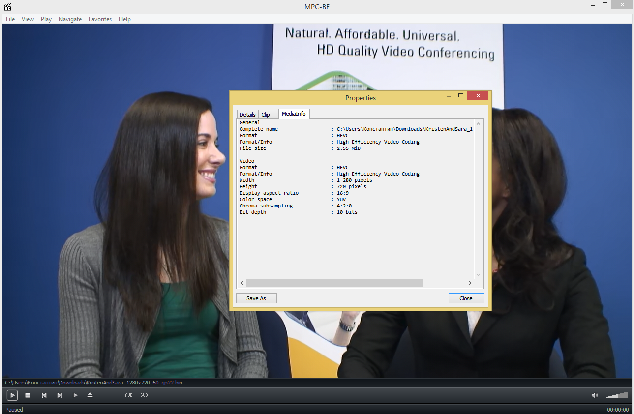

  15. WTF Profile 10bith depth ??
  16. and? no info about encoder version, command line options,... -> what is the surprise for?
  17. Originally Posted by Selur View Post
    http://ftp.kw.bbc.co.uk/hevc/hm-10.0-anchors/bitstreams/
  18. Okay, so you posted a non x265 created clip in the "x265.EXE: mingw builds" thread, to show your surprise about what?
    That there are HEVC streams with 10bit output precision?
    Shouldn't be a surprise, HEVC has a Main10 profile and with the Range Extension it even has a Main12 profile.
    -> unless there is a question related to x265 somewhere, you better open a new thread and formulate a question there.
  19. Originally Posted by Selur View Post
    Then why not have a version with these profiles?
    I think to an 8-bit general can have long forgotten.
    Even if you finish it when the x265, 8-bit profile itself is not needed.
    For in this case, but it does not say 10-bit x264 profile is better than him.
    Let's say I'm doing exclusively with the profile High 10 in x264. As soon as it came out, it became immediately clear that this is an 8-bit past.
  20. Then why not have a version with these profiles?
    Simply because, like mentioned before, the high bit-deth code hasn't been rewritten/optimized.
    Going from 8bit to 10/12/16bit precision isn't that simple and can be easily done.
    If you want to speed-up the Main10 support, contact the x265, tell them what you can do and they might have an idea how you can help.
