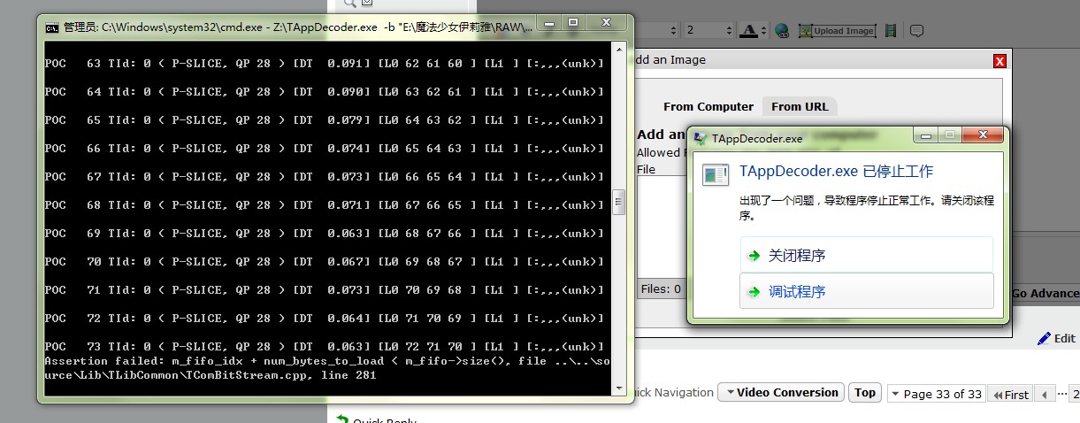

    HM12 not work properly decode
    This is the BUG X265
    HM crash
    I have repeatedly complained about the WPP problems X265

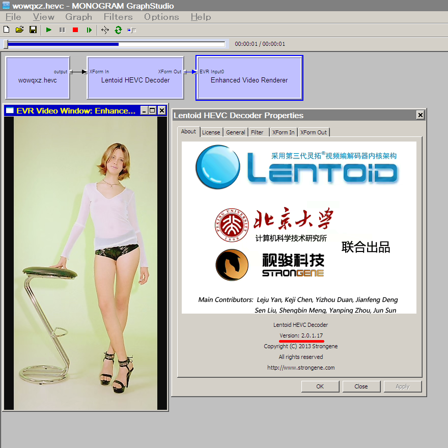

    FWIW, yet another image:
  15. Originally Posted by El Heggunte View Post
    Originally Posted by vhelp View Post
    confirmed, strongene lentoid decoder is borked. it won't play whether WPP is turned on or off.
    i made two encodes, neither will play while using strongene lentoid decoder { v2.0.1.17 }
    but mpc-be plays both videos perfectly.
    video.[0.5+371, q15, --wpp=on].hm10
    video.[0.5+371, q15, --no-wpp=off].hm10
    I cannot confirm the alleged problem. The latest Lentoid decoder does work fine here, with the most recent build from x265.cc
    Signed.
    "MPC-HC.1.7.0.208.x86" + "Strongene PC HEVC/H.265 Decoder V2.0.1.17" + "madVR" = WORKS
    tested with the "tos_60s_hevc.crf24.mp4" sample from "LigH.de" (great sample btw.)
