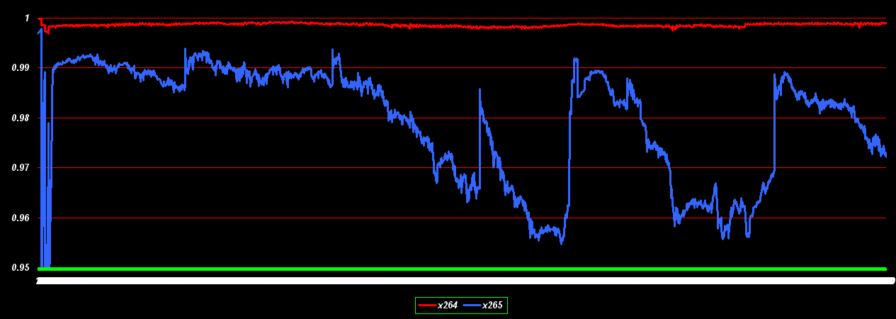

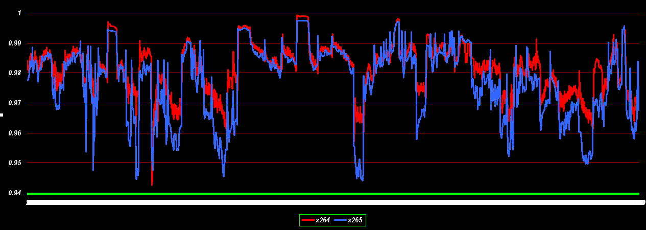

  14. What's this bpp terminology now? I assume it doesn't stand for bits per pixel.
    EDIT: I did a test on a music video and x265 is ahead of DivxHEVC but still lagging behind x264. Many frames marginally better, a couple staggeringly worse so it easily brings down the average SSIM.
    First chart is the music video, second is the video game capture. Damn, the power of mb-tree...

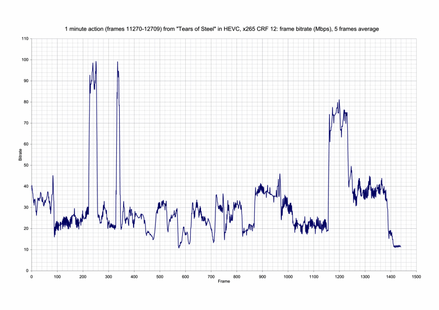

    In case someone is interested in speed-testing HEVC decoders:
    I just encoded a 1 minute snippet from "Tears of Steel" using x265 with CRF 12, but still a slower preset to ensure a high complexity to stress decoders. It has an average of ~31.3 Mbps video bitrate. Peaks are around 100 Mbps (if I can use the bits-per-frame log as reliable presentation base).
    tos_60s_hevc.mp4 on MediaFire (224 MB)
