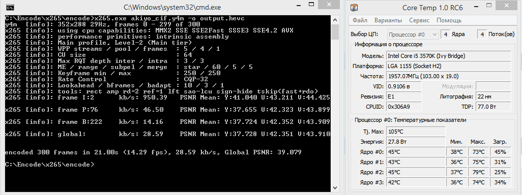

  27. Originally Posted by x265.cc View Post
    x265.exe akiyo_cif.y4m -o output.hevc
    Intel Core2Quad Q9000 (6M Cache, 4x2.00GHz); 4096 MB DDR2; Windows 7 Enterprise x64 SP1:
    GCC 4.8.1: encoded 300 frames in 112.39s (2.67 fps), 28.59 kb/s, Global PSNR: 39.079
    GCC 4.8.2: encoded 300 frames in 114.97s (2.61 fps), 28.59 kb/s, Global PSNR: 39.079
    VC11-x86: encoded 300 frames in 92.08s (3.26 fps), 28.59 kb/s, Global PSNR: 39.079
    VC11-x64: encoded 300 frames in 73.71s (4.07 fps), 28.59 kb/s, Global PSNR: 39.079
    Intel Core i5-760 (8M Cache, 4x2.80GHz) ; 4096 MB DDR3; Windows 8.1 Enterprise x64:
    GCC 4.8.1: encoded 300 frames in 65.98s (4.55 fps), 28.59 kb/s, Global PSNR: 39.079
    GCC 4.8.2: encoded 300 frames in 66.89s (4.48 fps), 28.59 kb/s, Global PSNR: 39.079
    VC11-x86: encoded 300 frames in 55.02s (5.45 fps), 28.59 kb/s, Global PSNR: 39.079
    VC11-x64: encoded 300 frames in 43.45s (6.90 fps), 28.59 kb/s, Global PSNR: 39.079
    Intel Core i5-3570k (6M Cache, 4x4.63GHz) ; 16332 MB DDR3; Windows 8.1 Enterprise x64:
    VC11-x86: encoded 300 frames in 26.85s (11.17 fps), 28.59 kb/s, Global PSNR: 39.079
    VC11-x64: encoded 300 frames in 21.00s (14.29 fps), 28.59 kb/s, Global PSNR: 39.079

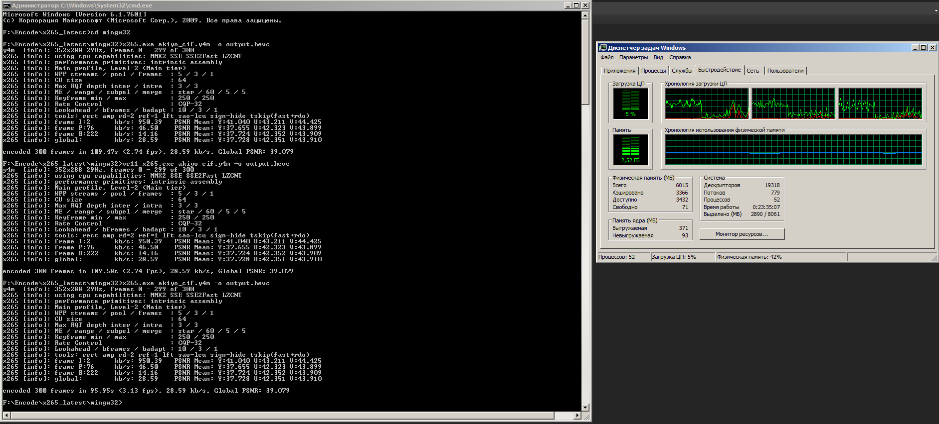

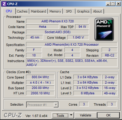

  28. Member
    Aug 2013
    Kharkov, Ukraine
    AMD Phenom II X3 720B (three cores at 2.8ghz) | Windows 7 x64 | 6GB DDR II
    Used instructions:
    using cpu capabilities: MMX2 SSE SSE2Fast LZCNT
    Why it dont use SSE3 or SSE4A?
    Cpu load very low, is about 45-55%
    MinGW 32bit - encoded 300 frames in 109.47s (2.74 fps), 28.59 kb/s, Global PSNR: 39.079
    VC11 32bit - encoded 300 frames in 109.58s (2.74 fps), 28.59 kb/s, Global PSNR: 39.079
    VC11 64bit - encoded 300 frames in 95.95s (3.13 fps), 28.59 kb/s, Global PSNR: 39.079
  29. Why it dont use SSE3?
    Wild guess: Nobody, hasn't written any SSE3 specific code. -> Make a HUGE donation to the project, so they can hire someone to do it or wait till the basic code is working properly,...
  30. Originally Posted by Selur View Post
    nope.. see Fllear's screenshots (or the x265 repo).
    Core2Quad Q9000 output (vc11/mingw):
    x265 [info]: using cpu capabilities: MMX2 SSE SSE2Fast SSSE3 SSE4.1 Cache64
    @mindwin: LZCNT should mean SSE4A
