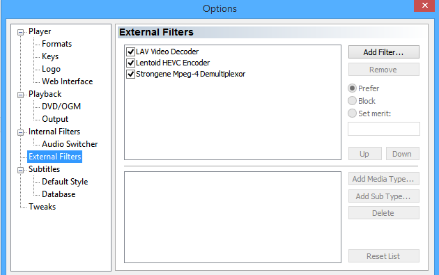

  1. Can anyone help? How many do not try MPC did not want to show mp4 or mkv. Just then all the writing in the subject that look normal. But it does not say who does not like set up.Click image for larger version

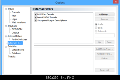

    First of all, the HEVC Encoder should not be on that list Secondly, set the merit of the MP4 Demultiplexor and of the Monogram FLV Splitter to something *** greater than 00800004 ***, unless you have already reduced the merit of LAV Splitter to something less than 00800000 --- in this case, then, you can set the merit of the Strongene filters to "Preferred".
    NOTICE: so far, LAV Splitter does not support the MKVs generated by/for the DivX software, only the MKVs that use the VfW-compatible mode. And it seems that the proper HEVC support will be implemented only "sometime before next Christmas"

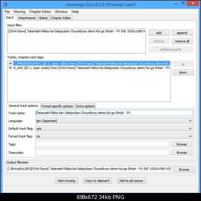

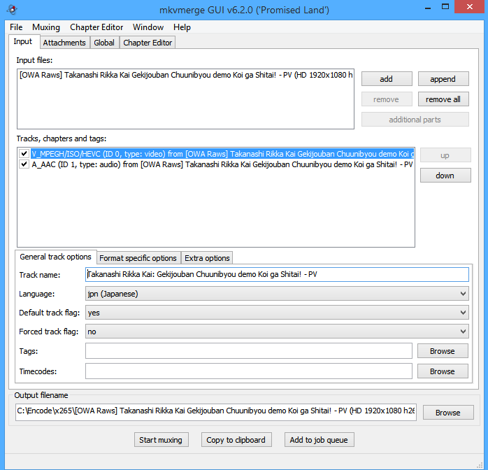

  6. Thank you. But not running. Possible conflicts with windows 8.1
    By the way 10-bit profile is already available or not yet? How to use it?
    And applying a GUI for the MKV package for DIVXPlayerClick image for larger version

    Nov 2002
    Originally Posted by 4h8s View Post
    I ......had ..............failed. It had an error if I start the encoding from vdub's external encoder:
    Cannot load DLL file: MSVCP100.dll
    I am using DivX265.exe
    Originally Posted by DarrellS View Post
    MulicoreWare better get their asses in gear. DivX HEVC now has command line encoder and HEVC mkvmerge to mux the files. This encoder accepts Raw input, AVS input, AVI input and Piping from stdin.Works great in Virtualdub with the external encoder.
    Encoder
    http://download.divx.com/hevc/DivX265.exe
    I am a failure. My brain is now the size of a decrepit dilapidated incapacitated threadbare walnut.
    Dot dot dot.
    First, for the dll error, I believe you need to install Microsoft Visual C++ 2010 SP1 Redistributable to fix the error
    http://www.microsoft.com/en-us/download/details.aspx?id=8328
    Second, I forgot to edit the post with the instructions in this thread. I fixed it in the other threads.
    The muxing process fails with the normal mkvmerge command because the Rovi build does not use the "--default-duration 0:%(fpsnum)/%(fpsden)fps" command but uses the actual frame rate (24000/1001 for example) or remove the muxer from your encoder set and manually mux the files using the Rovi mkvmerge. You'll need to place a copy of mmg.exe (the gui) from mkvtoolnix 6.2.0 into the Rovi MKVToolNix 6.2.0 folder since it does not come with the gui and place a shortcut on your desktop.
    I'll edit the instructions in the original thread so other do not make this mistake.

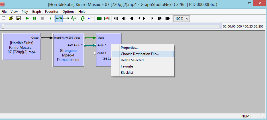

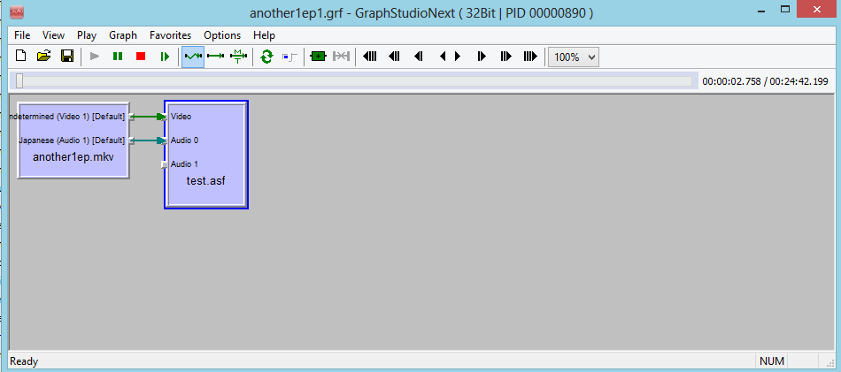

  14. Originally Posted by vhelp View Post
    however, i stopped most of my playing around with x265.exe because without any proxy/frameserving support, the whole process becomes too laborous to bother and sooner or later one looses their mojo or interest.
    Well, with 1-click-encode it is not that complicated, but sure temporary y4m files are troublesome, if you are testing on long encodes like me.
    got a question about the divx encoder, is there any workaround to get their streams working without divx player? Ive been trying, but my muxed files/ raw streams will not show video ( lentoid is not compatible with hevc encoded by divx or what? ).
    Im not talking about their hevc-in-mkv, but about hevc stream decoding.
    @Fllear
    You can have a look at that, i mkvmerge'd what i earlier muxed with 'avi mux' back then i think ( both mpc-hc mkv muxer and avi mux, which does work if you don;t use bframes you will find under graph->insert filter ). You have to register the asf muxer with the .bat file earlier if it doesn't appear.
    notes:
    you can drag&drop the source mkv on graphstudio exe
    ignore the audio pin in the pictures
    you might need to disable 'playready' and 'source is h264' options in properties window of asf muxer ( right click )
    I wasn't able to get audio working though.

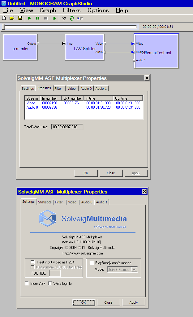

  15. DECEASED
    Jun 2009
    Heaven
    Jacobr, it seems the SolveigMM ASF Muxer does not understand AAC
    If you use MP3, AC3, or (probably) any constant-bitrate audio format, then certainly the ASF Muxer will accept that as a valid audio input.

    Encoding with no-wpp is just too slow so my work around to get a working file is to use mkvmerge from the rovi build and mux to divx and use the DivX player to play the files (could just use .mkv but MPC-HC is default player for mkv and file won't play in MPC-HC).
    I used the recommended settings in the PDF with my working argument for around 8 fps on a 1024x576 24p file...
    x265 --frames all --q 24 --keyint 40 --max-merge 3 --hash 1 --no-rect --wpp --tu-intra-depth 1 --tu-inter-depth 1 --no-tskip --frame-threads 4 --input "input.y4m"  --output "output.hevc" & mkvmerge.exe --default-duration 0:24fps "output.hevc" -o "output.divx"
    For audio, use...
    mkvmerge --default-duration 0:24fps --aac-is-sbr 0:1 "output.hevc" input.aac -o "output.divx"
