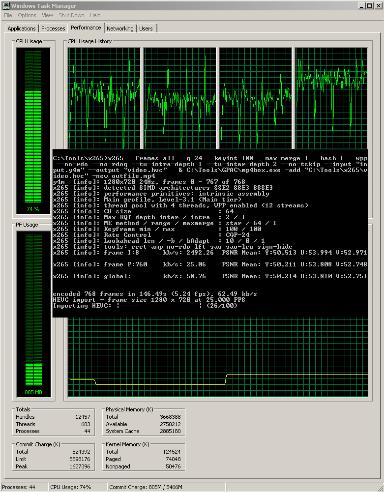

    I changed up my argument a little and got these numbers using a 1280x720 file. None of my high resolution files will play in MPC-HC but they all play in the Osmos4 player. Seems the other players have a lot of work to do if they're going to play these files with wpp.
    Here is my bat file for creating the y4m file, encoding to .hvc and muxing to mp4...
    avs2yuv.exe "C:\Tools\x265\input.avs" -o input.y4m & x265 --frames all --q 24 --keyint 100 --max-merge 1 --hash 1 --wpp --no-rdo --no-rdoq --tu-intra-depth 1 --tu-inter-depth 2 --no-tskip --input "input.y4m" --output "video.hvc" & C:\Tools\GPAC\mp4box.exe -add "C:\Tools\x265\video.hvc" -new outfile.mp4
    ...and my last encode using Q6600 processor and Windows XP Pro...

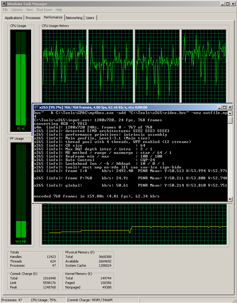

    OK, something weird in the 594 build. I got 4.80 fps in 562 but in 594, I only got 3.89 fps using the same input file and the same settings. It looked good about half way through at 5.38 fps then suddenly dropped. My CPU also dropped to under 50% and my memory dropped to 812MB.
    Will try 614 and see what happens.
    EDIT: 614 much better! Still not using very much memory though.
