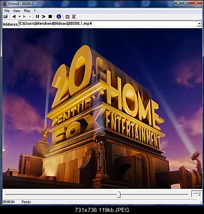

    Yes, as Brazil said mp4box included in my gui wasn't standalone build, so I added necessary(hopefully) dlls to package and re-uploaded it.
  2. x265gui_build89 is working perfectly. Look at the result of the video and audio:
    https://shared.com/mn0q7p8he3

    General
    Complete name : C:\Users\Marchand\Videos\00200.1.mp4
    Format : MPEG-4
    Format profile : Base Media
    Codec ID : iso4
    File size : 348 KiB
    Duration : 7s 465ms
    Overall bit rate : 382 Kbps
    Encoded date : UTC 2013-08-20 23:18:23
    Tagged date : UTC 2013-08-20 23:18:23
    Video
    Format : HEVC
    Format/Info : High Efficiency Video Coding
    Format profile : Main@L9.0
    Codec ID : hvc1
    Codec ID/Info : High Efficiency Video Coding
    Duration : 7s 200ms
    Bit rate : 257 Kbps
    Maximum bit rate : 328 Kbps
    Width : 720 pixels
    Height : 576 pixels
    Display aspect ratio : 5:4
    Frame rate mode : Constant
    Frame rate : 25.000 fps
    Standard : PAL
    Color space : YUV
    Chroma subsampling : 4:2:0
    Bit depth : 8 bits
    Bits/(Pixel*Frame) : 0.025
    Stream size : 226 KiB (65%)
    Title : 1.h265:FMT=HEVC@GPAC0.5.1-DEV-rev4707
    Audio
    Format : AAC
    Format profile : LC
    Codec ID : 40
    Duration : 7s 465ms
    Source duration : 7s 488ms
    Bit rate mode : Variable
    Bit rate : 129 Kbps
    Maximum bit rate : 141 Kbps
    Channel count : 2 channels
    Sampling rate : 48.0 KHz
    Compression mode : Lossy
    Delay relative to video : -21ms
    Stream size : 118 KiB (34%)
    Source stream size : 118 KiB (34%)

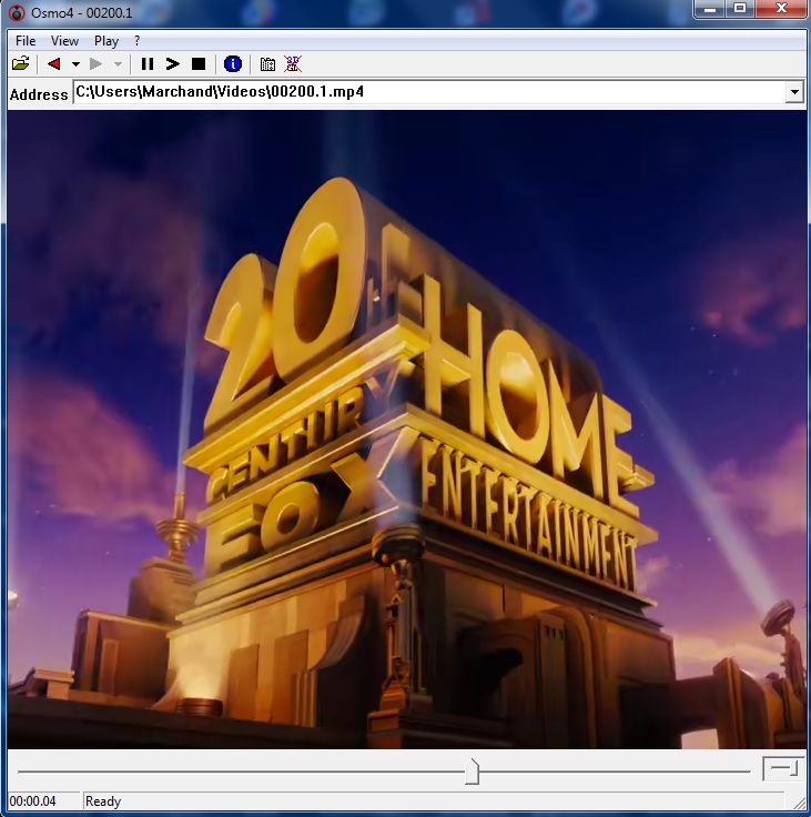

    General
    Format : MPEG-4
    Codec ID : iso4
    File size : 357 KiB
    Duration : 7s 465ms
    Overall bit rate : 391 Kbps
    Encoded date : UTC 2013-08-23 00:46:35
    Tagged date : UTC 2013-08-23 00:46:35
    Video
    Format : HEVC
    Codec ID : hvc1
    Duration : 7s 200ms
    Bit rate : 267 Kbps
    Maximum bit rate : 333 Kbps
    Width : 720 pixels
    Height : 480 pixels
    Display aspect ratio : 3:2
    Standard : NTSC
    Color space : YUV
    Bit depth : 8 bits
    Bits/(Pixel*Frame) : 0.031
    Stream size : 235 KiB (66%)
    Title : 1.h265:FMT=HEVC@GPAC0.5.1-DEV-rev4704+53 git-de3a049
    Audio
    Format : AAC
    Format profile : LC
    Codec ID : 40
    Duration : 7s 465ms
    Bit rate : 129 Kbps
    Stream size : 118 KiB (33%)
    Source stream size : 118 KiB (33%)
