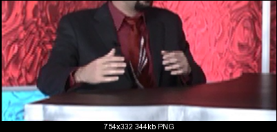

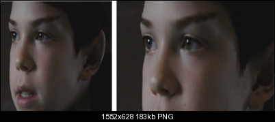

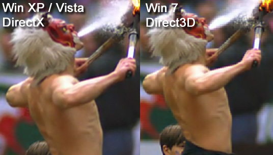

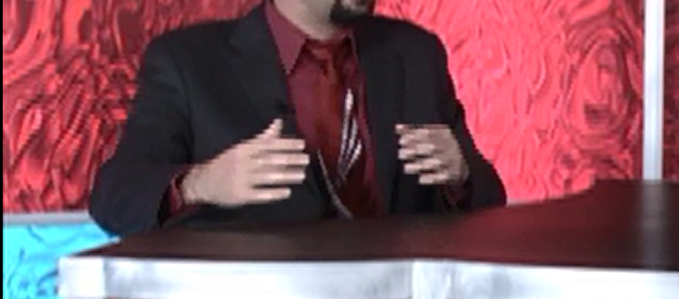

    The pic below is thanks to others who posted photos describing the issue, kindly ignore any text on image, just look as a sample to see the issues, left ok right side bad.
    thanks in advance
  2. looks like the deblocker during decoding is not working.
    If you use MPC-HC:
    - Which decoder is used during playback?
    - Which renderers have you tried?
    - Have you tried using madVR in combination with MPC-HC?

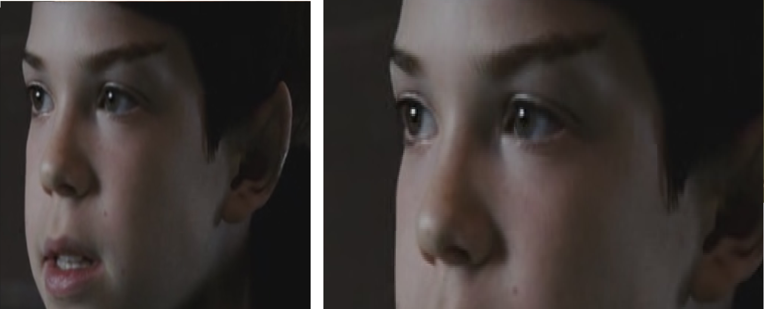

  3. Hmm..On the top two, the one on the right looks better to me. On the bottom two the one on the right is same as left but enlarged so it would normally be a little fuzzier. Posting someone's photo may not help us figure out your problem. But you have a different video correct? What is the video source?

  5. Originally Posted by TreeTops View Post
    Since I no longer have my win xp i cant take proper screen shots of the same content to post, but all the photos I found online of the problem are exactly the same.

  6. Post a screen cap of the bad video. Made on your computer, not somebody else's that looks similar.

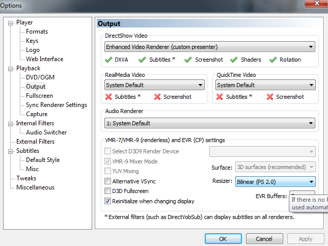

  8. Most likely your re-sizer was not set at least in Bilinear mode
    MPC-HC

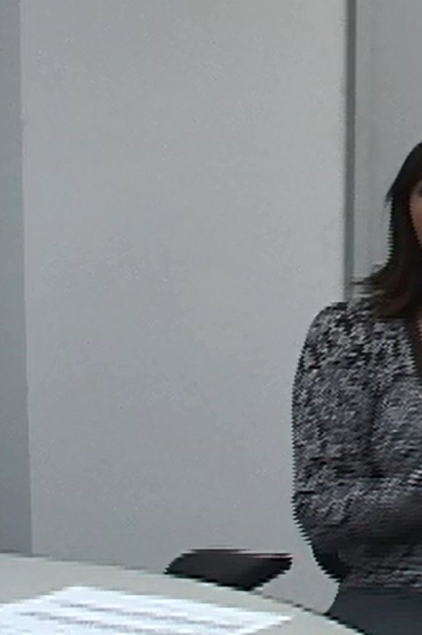

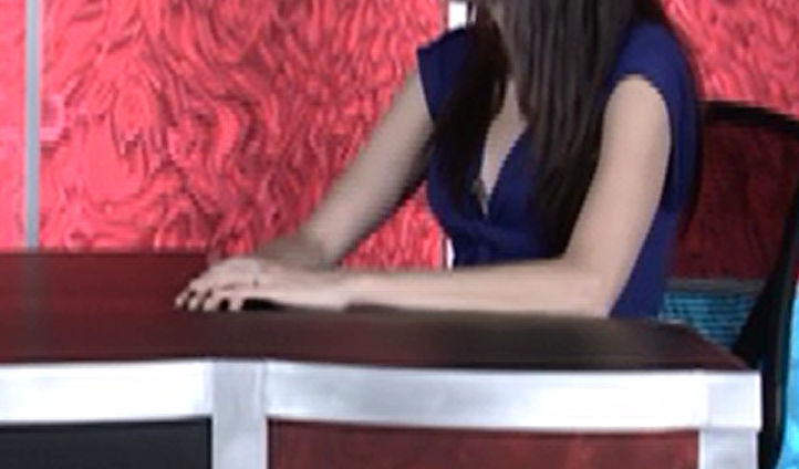

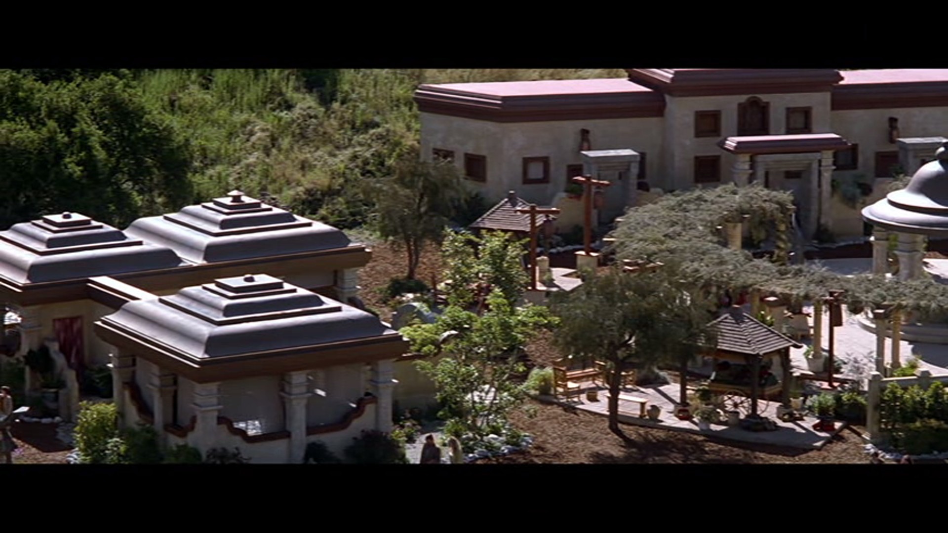

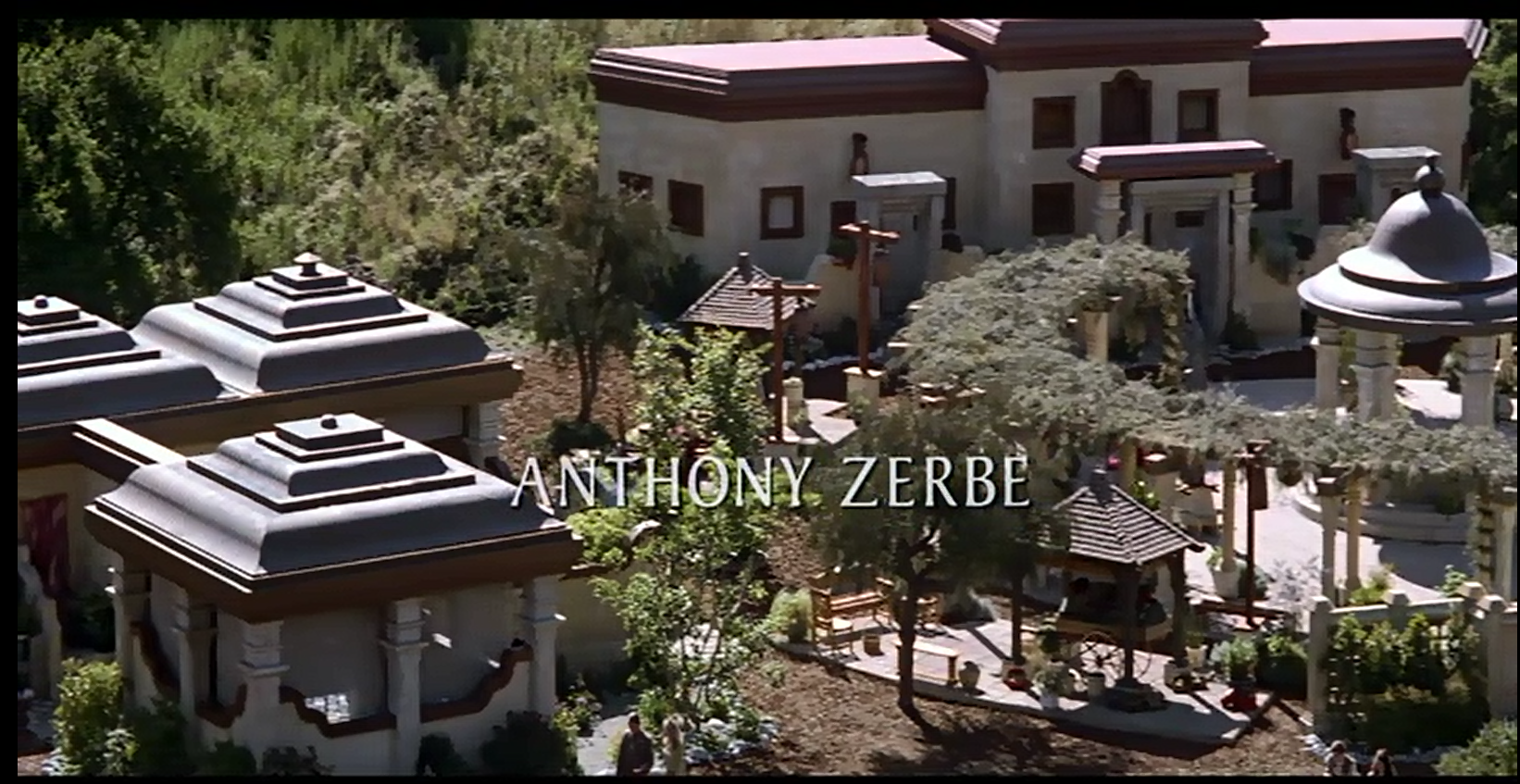

  9. Thanks for trying to help
    To Atak tried that with no luck

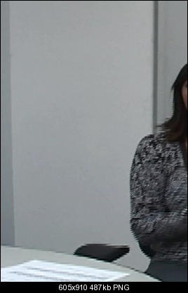

    I am posting some samples, keep in mind when I paused video to take screenshot it made it a bit worse on the pause but its pretty close to how things look.
    I tried all file types mentioned in my orig post all with same result,

  10. Now I suspect that you have activated some dumb deinterlacer. Can you post screenshots on some high quality 720p rips or 1080p?
  11. The first is probably just too low a bitrate. The second is an interlaced source encoded progressive. The last may have been poorly interlaced. What does a well produced video look like?

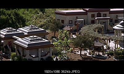

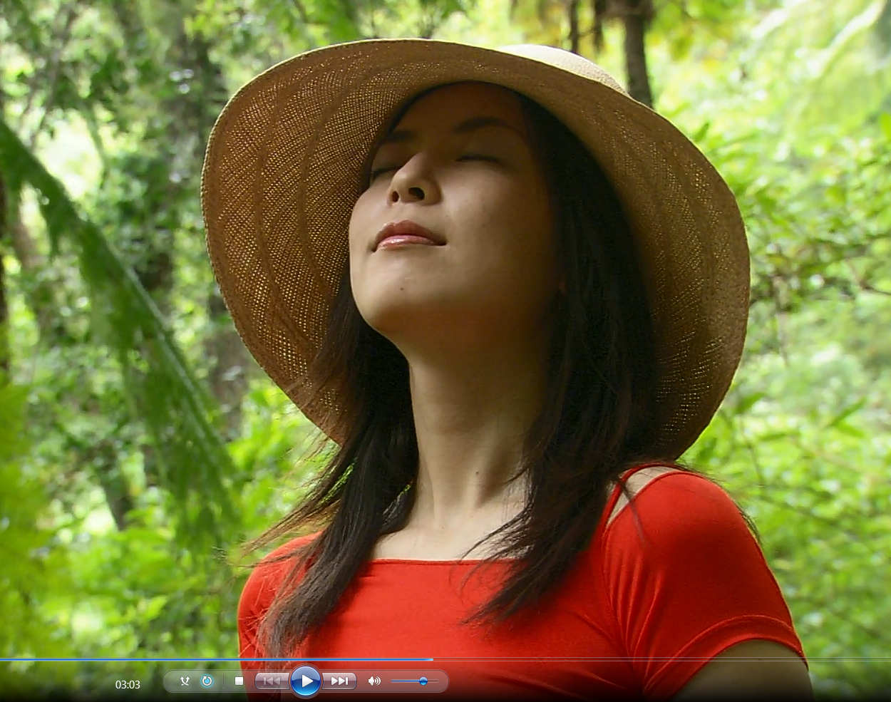

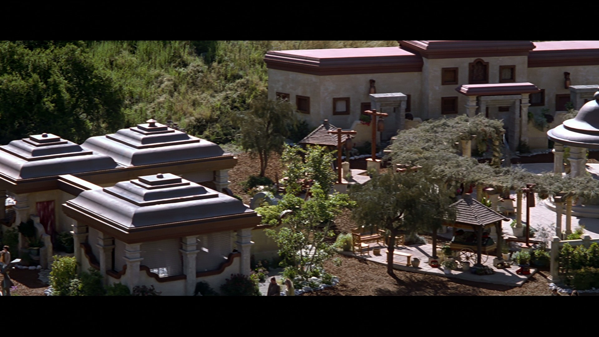

  14. How does this 1080p clip (Blu-ray rip) look on your computer? Here's what I see:

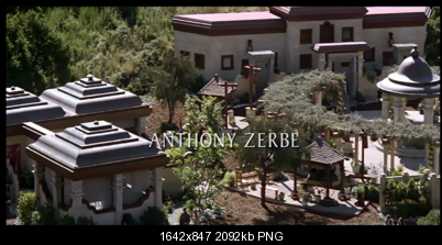

  15. And how about this clip (full screen)? The idea is to isolate decoding (paramount.mkv) and scaling (xvid2.avi).

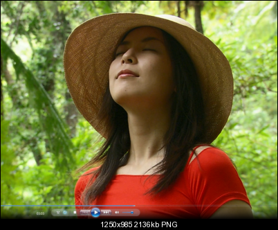

  16. hi
    here is a sample I downloaded from demo world called souther paradise
    Dolby Digital 2.0 1080/29.97p 20.02.10
    amazing how crystal clear it is, the screenshot might degrade it a bit but its amazing
  17. problem solved! next!

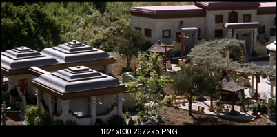

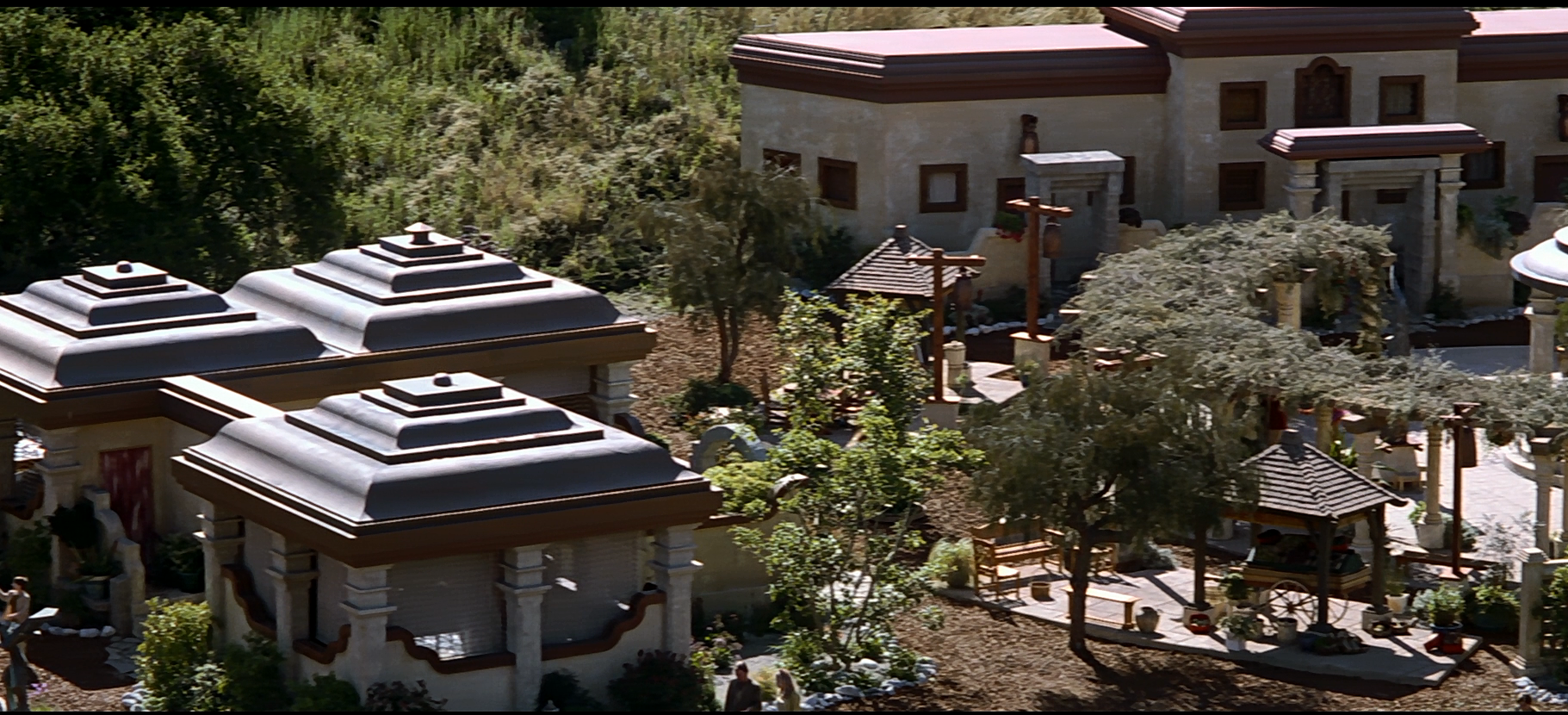

  18. xvid file
    mkv file
    on xvid file notice the roof on the building on the back has a big jagged edges while mkv is clean
    thanks again

  20. do not expect super detailed image if movie is not in your lcd native resolution. upscaling will always degrade image quality.
    Xvid is in 720x480 while mkv is in 1920x1080 !
    So once again. Problem solved! Actually problem never existed You just have crappy sources. That's all.

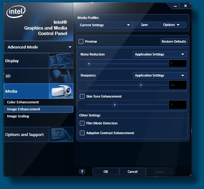

    Your images look about like I would expect. Except the the Xvid image is over sharpened. Go to the graphics card's setup applet and turn off all the video "enhancement" features. The applet is different for different graphics cards but here's an example of one:
    Also, did you do what Atak_Snajpera suggest in post #8?

    first off thanks allot, I happen to have the same interface as you (intel) I copied your settings and a huge part of the fuzzyness and jagged edges are gone! Thing is I went from a 19 inch old monitor (square) to a 23inch lcd so like atak said it wasnt high quality all along its just more pronounced with my new system.
    As far as post number 8 I copied all settings, but there is one checkbox that is checked and greyed out and I cannot uncheck it, that is the box vmr-9 mixer mode,
    thanks
  23. Another thing you might try is disabling the DXVA decoders in MPCHC. View -> Options -> Internal Filters (left pane) -> Transform Filter (right pane): H264/AVC (DXVA), VC1 (DXVA), WMV (DXVA). Only use the software decoders (the FFmpeg equivalents).
