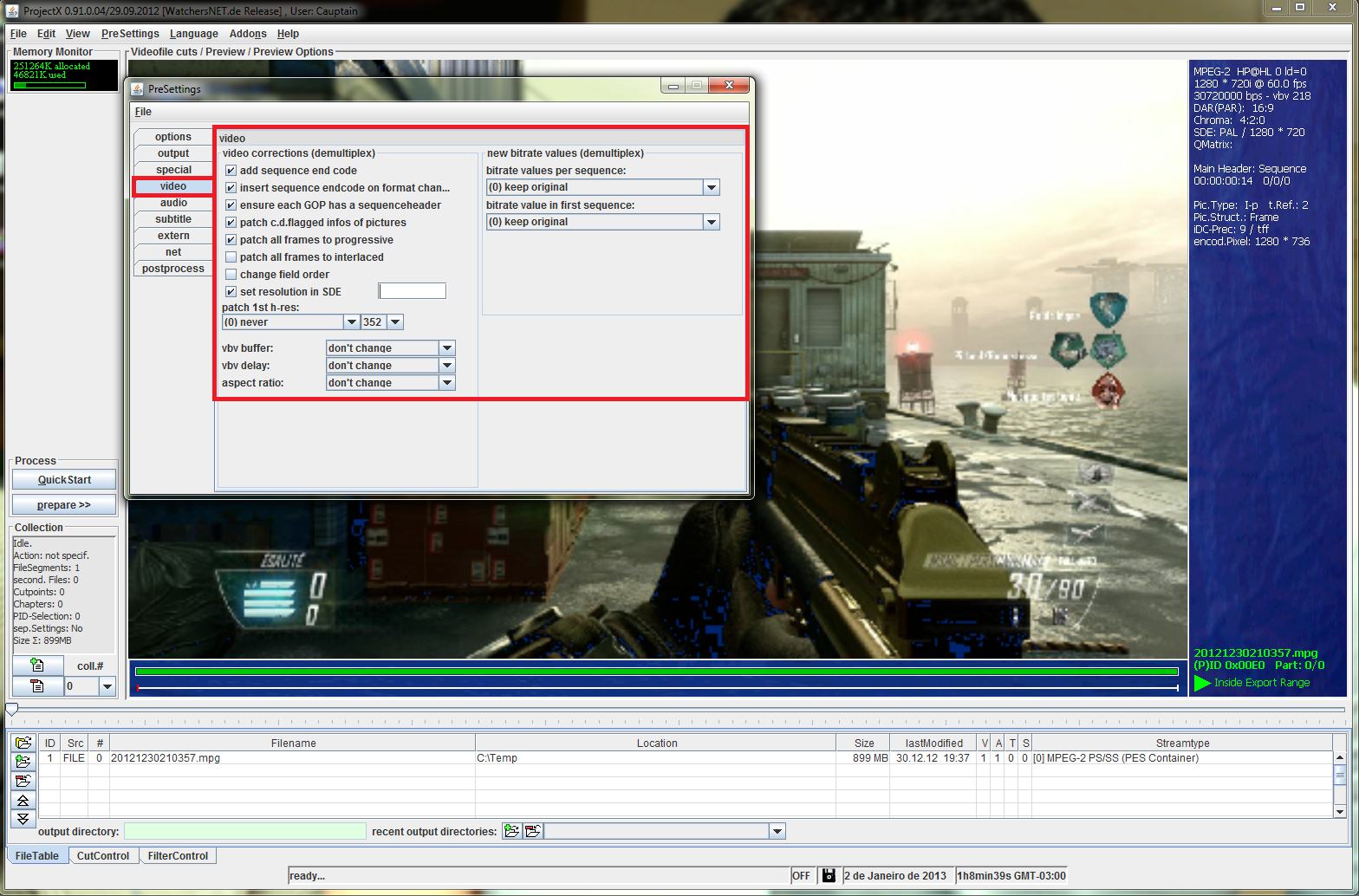

Hi JAX75,
Its my help u.

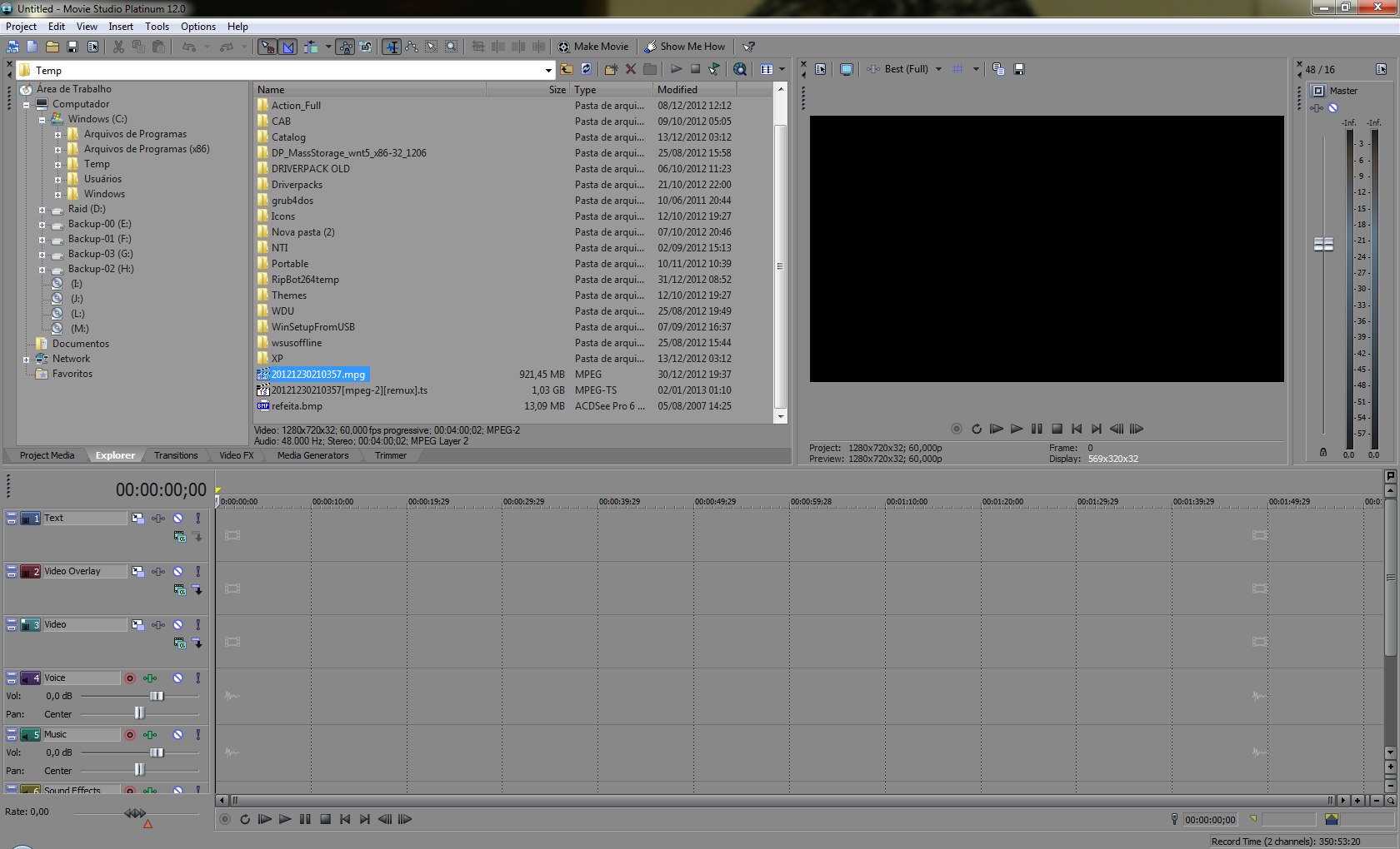

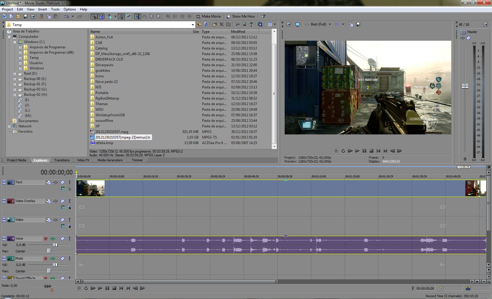

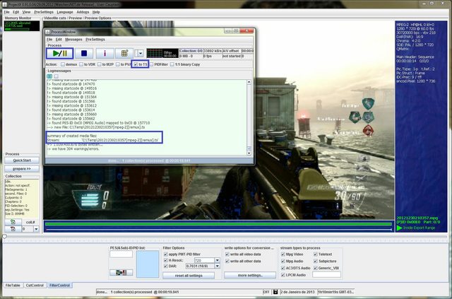

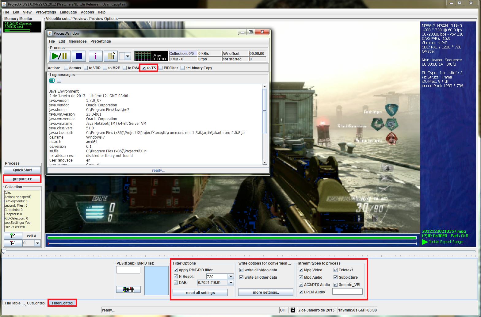

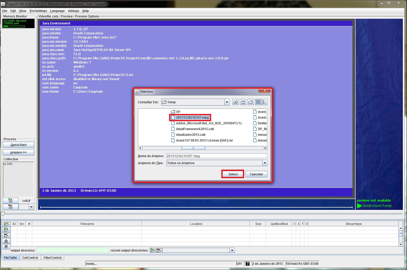

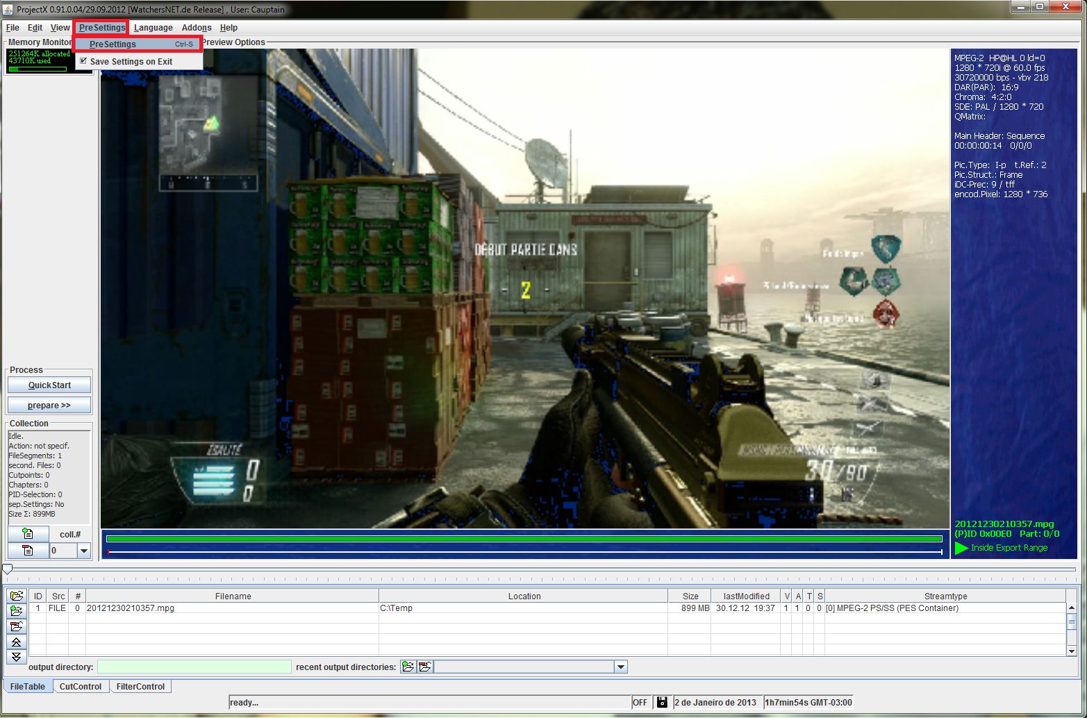

How to make Avermedia capture MPEG2 files full editable with no erros using Vegas:
1 – Download PROJECTX: https://www.videohelp.com/tools/ProjectX
2 – Config like shots above
3 – Enjoy.
Remember to make changes to correct video config input (1080i, PAL, etc...)
Claudio
