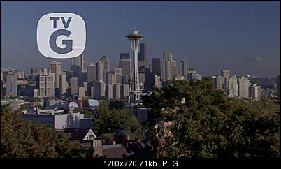

    I've recently noticed my videos play well, unless they are in HD format. See how the image is pixelated.

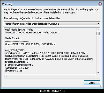

    Here's a message I see when I open these videos with MPC:

  4. Search google for
    dx9 allocator presenter failed
    And you'll get some suggestions about reconfiguring direct draw / direct 3d. Perhaps that will help.
    These top two links look good:
    http://answers.microsoft.com/en-us/windows/forum/windows_7-pictures/error-code08876086...6-6dd6da1ae952
    http://www.wintips.org/media-player-classic-error-code-0x8876086a/

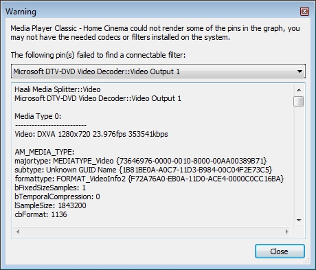

    Here's the error message I get:

    I find it weird I keep getting errors after uninstalling and cleanign the registry...
    The only video related program I installed lately was WinPcap, but I've already uninstalled... so I think it shouldn't be the cause... =/

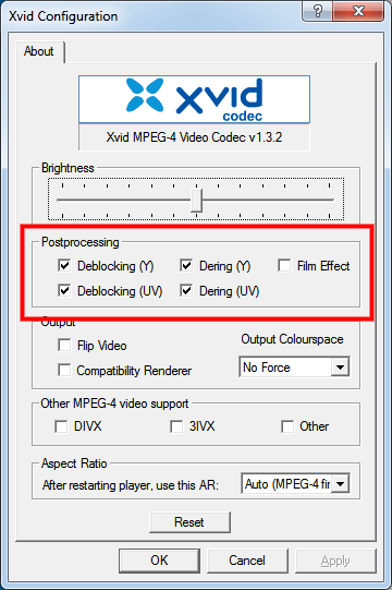

  18. Originally Posted by Usurario View Post

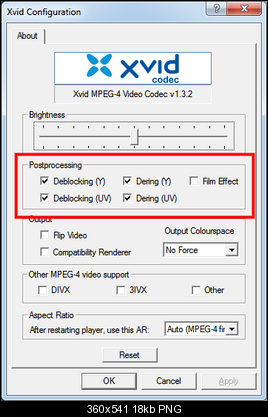

    Turn on the decoder's deblocking filter. For example, with Xvid:

    Thanks, jagabo. As for ffdshow, I've done the following: opened ffdshow video decoder configuration > selected Postprocessing (on left menu) > marked accurate deblocking (on both 32 and 64 bits versiobs of the config software). No results. And as for MKV, I haven't found no option for deblocking...

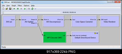

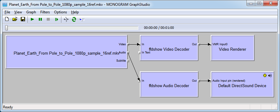

    How do you know? The process of playing an A/V file involves a file reader, file splitter (sometimes the reader and splitter are the same filter), audio decoder, video decoder, some times a colorspace converter, sometimes and audio converter, an audio renderer, and a video renderer. LAV can be used simply as the reader/splitter while something else may be used to decode the video. In addition, a program can use its own internal filters for reading/splitting/decoding. So it's not always easy to determine what's in use when playing a video.
    Here's an example of a DirectShow filter graph:
    In this filter graph Haali is being used as the MKV reader/splitter, ffdshow, to decompress the audio and video, then the graphics and sound renderers to show/play the video and audio. A more complex filter graph:

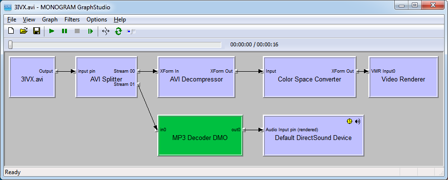

    This one uses a separate reader and splitter, and a colorspace converter.

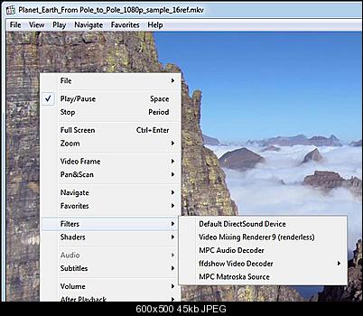

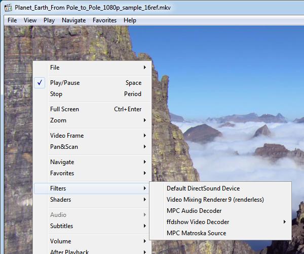

    Some players have a feature where they show you which filters are in use. With MPCHC, for example, you can right click on the window while a video is playing and hover over Filters in the context menu. You can select any of the filters to get more information and change parameters.
