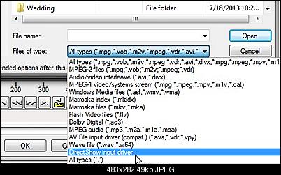

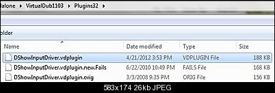

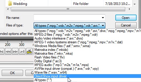

    You can do it 2 ways:
    If you have the DShowInput Plugin, Select it in types and then select the AAC file. Otherwise I just select ALL in type box and select the AAC file.
Name:	ScreenHunter_15 Jul. 26 15.10.jpg
Name:	ScreenHunter_15 Jul. 26 15.11.jpg
    That's the BOTTOM ALL TYPES *.* not the top one that denotes mostly video files.
    Last edited by Budman1; 26th Jul 2013 at 16:16. Reason: Correction to selection line.

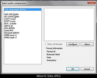

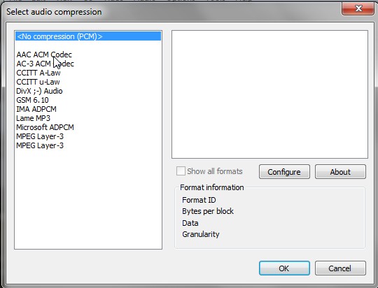

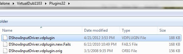

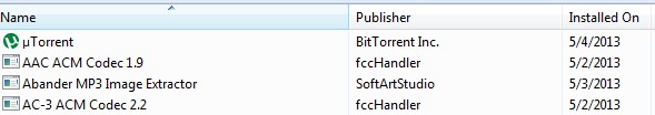

    My experience, on Windows 7 Ultimate at least, with VirtualDub 1.10.3, allows me to import the AAC audio as other file audio . Be sure it is playable on some player(I like PotPlayer because it has not let me down) and then check VirtualDub under File -> File Information and also use MediaInfo to check what it thinks it is.
    If they all agree, then set audio to full processing and check under Audio -> Compression and see if you actually have the AAC ACM (And possibly AC-3 ACM):
Name:	ScreenHunter_15 Jul. 26 17.38.jpg
    These are the ones I use:
Name:	ScreenHunter_15 Jul. 26 17.39.jpg
    This works either with DirectShow filter or All *.* for me. HOWEVER, bear in mind, the AAC in a decode only at least at this level and VirtualDub may be a little troublesome with 6 channel, if somehow you have 6 channel AAC.
