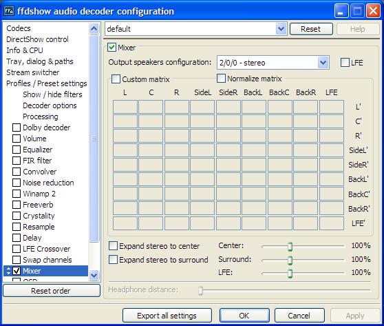

    Check if FFDshow is set up properly, the mixer should look like this (see below):
