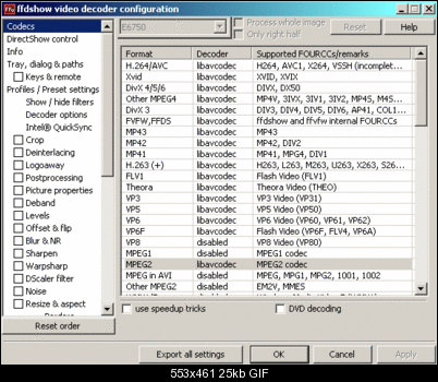

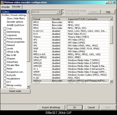

  6. VirtualDub uses Video For Windows codecs. I didn't think LAV installed any. ffdshow has two decoder configurations. The standard "Video Decoder Configuration" (DirectShow) and the "VFW Configuration". Are you using the latter?

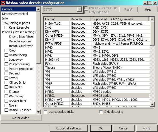

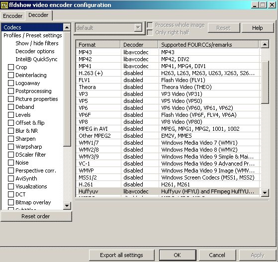

  8. There's two different shortcuts in the start menu, if the VFW option was included when installing. I can't remember but you may be able to choose not to. The "VFW Configuration" has Encoder and Decoder tabs and the Window name will probably be "ffdshow video encoder configuration". The "ffdshow video decoder configuration" is just DirectShow decoders.
    VFW:

    DirectShow:
