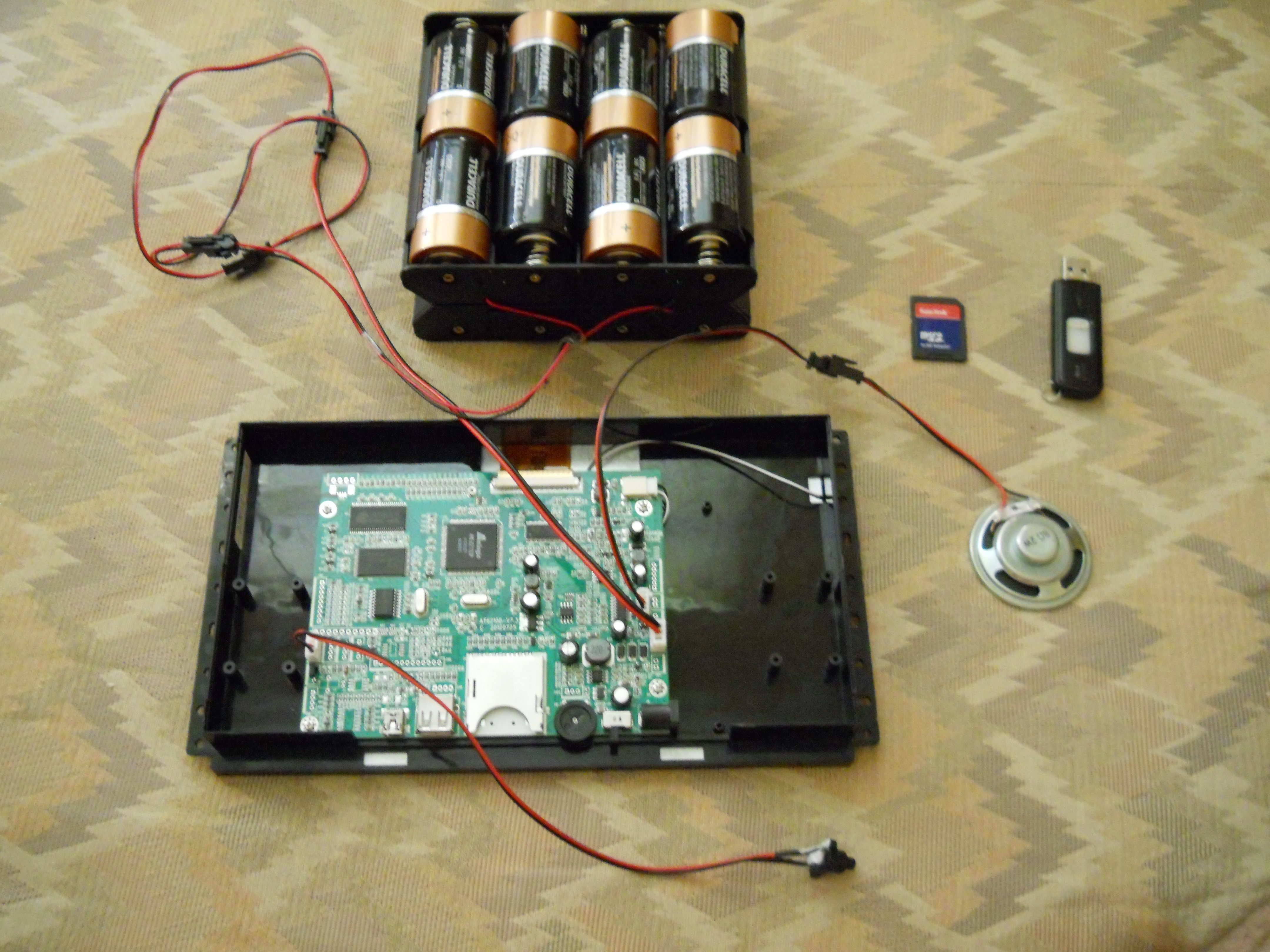

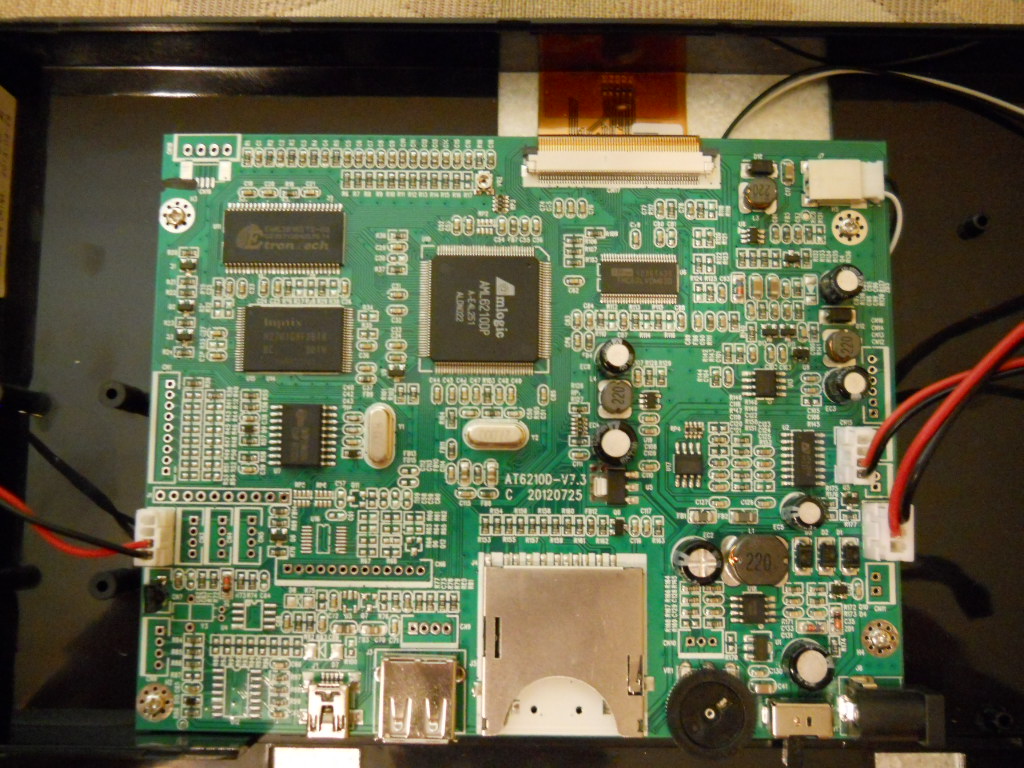

  10. 1.) This is a top do view of the back pannel.
    2.) This shows the ports (left to right is usb mini port, standard usb port, SD card slot, volume control, on of switch, and an adapter plug).
    3.) This is a close up of the motherboard.
    4.) And this is the front of the screen when powered on and the video begins to play.

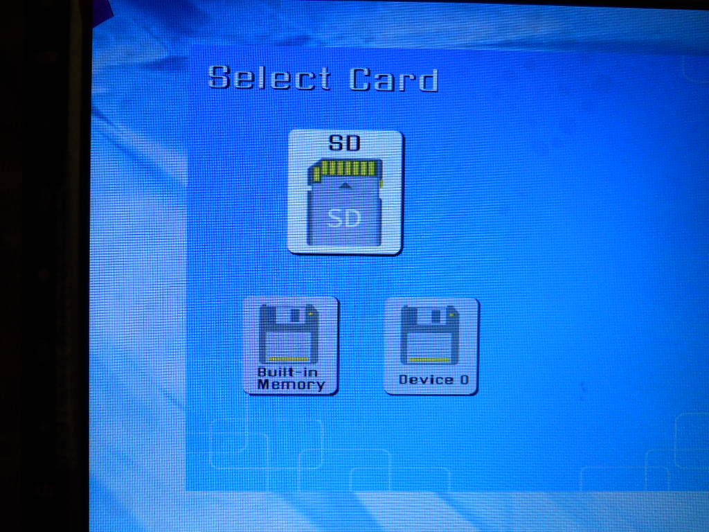

  12. I put in an SD card and a flash drive when I started it up, and it stays on the white screen until I eject one or the other. once I do this screen pops up asking where to load from. the SD card, internal memory, or device 0 (my flash drive) I cannot locate any buttons on the device, so I have no idea how to select which to boot from.

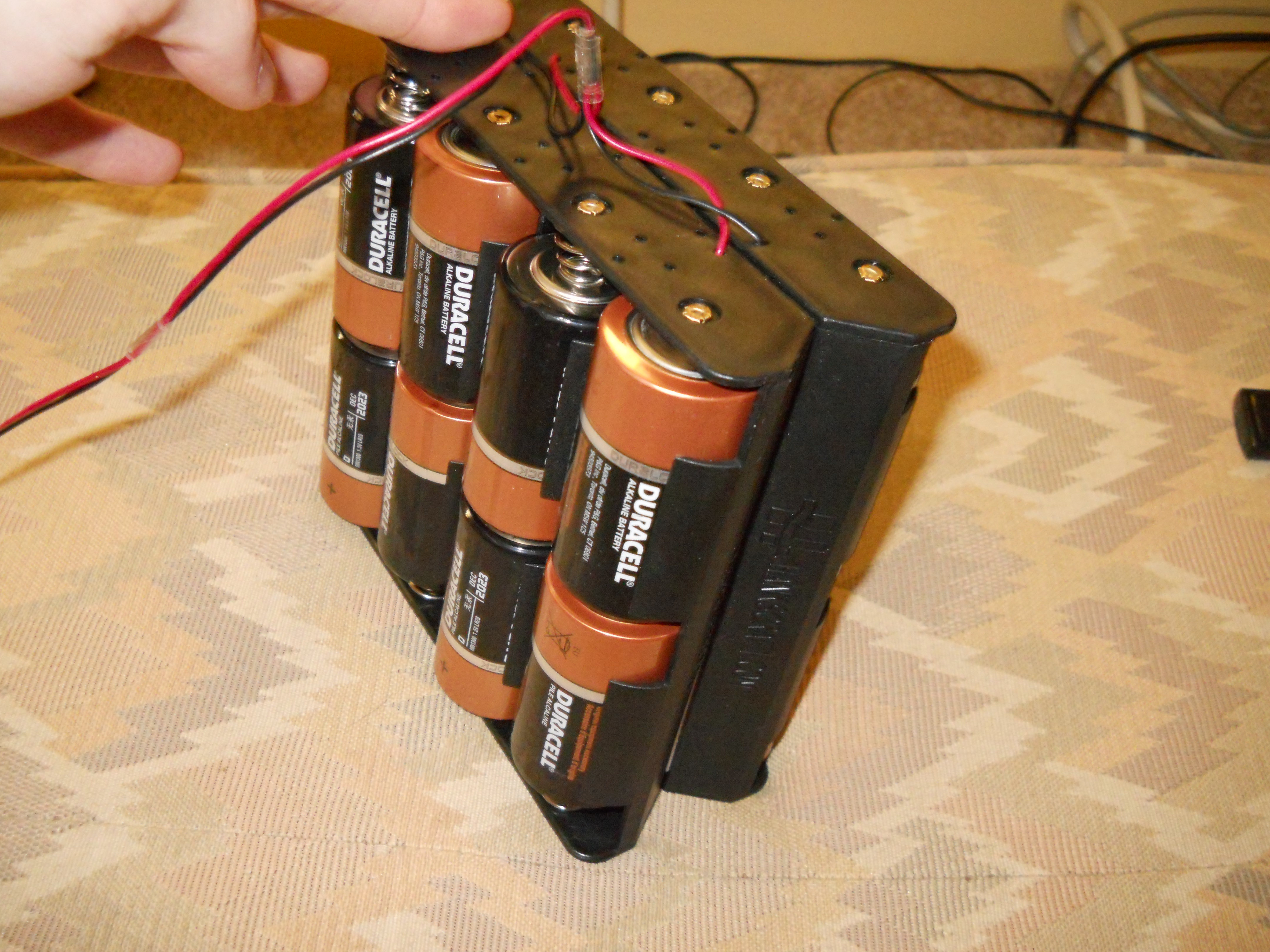

  13. also, can anyone tell me how many volts this device needs, seeing the batteries setup this way? It's 16 D's

  14. Member rickydavao's Avatar
    Jun 2007
    Victoria, Canada
    The device looks similar to this:
    http://acemi.manufacturer.globalsources.com/si/6008821994319/pdtl/LCD-advertising/1049...dvertising.htm
    But I haven't managed to find any other information on the web as of yet ...

  18. aBigMeanie aedipuss's Avatar
    Oct 2005
    666th portal
    looks like 12 volts worth of batteries.
  19. I would agree with you aedipuss, however, it's 16 D's not 8, so I was thinking it was 24 v, but I do know how you string them together affects voltage too. I just want to make sure I know what I'm plugging in for the adapter so I dont fry the board. If I can hook this up right and have it load from an Ipod via usb, then I could have a bigger screen and maybe hook it up in my car so people in the back seat would have video and music idk, there's a lot of things I could do with this.
  20. I figured out how to work the device. it auto-loads from the flash drive first. However, the video files MUST be named "00" then "01" , "02" etc. also, the voltage is 12 volts, so I can now use an adapter instead of 16 D batteries. (what on earth am I going to do with those D batteries now? thats like 30 bucks worth of batteries. lol. internal memory is fully rewritable, so i just deleted the ad video. thanks for the help guys. : D

  23. Member DB83's Avatar
    Jul 2007
    Maybe you simply touch the icon on the screen.

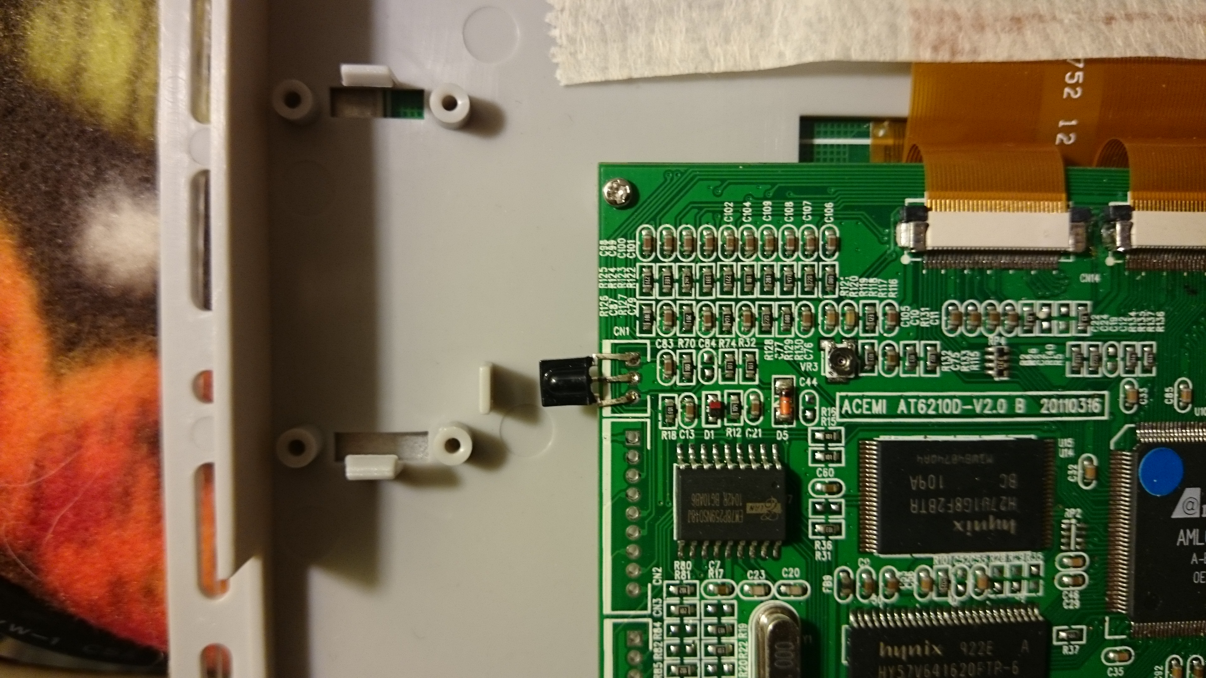

  24. Member
    Aug 2014
    Milwaukee WI
    [Attachment 26961 - Click to enlarge]
    Mine has an IR sensor on the back, I am trying to use the search option on a universal remote. It came in a NERF display.
