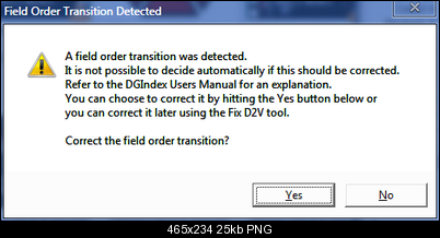

  8. Yeah, I figure if it's not interrupting the process then, it doesn't matter. One last question. When I demux the files with DGindex, at the end it says that there's a field order transition. Is there a way for me to check where the transition is in the d2v file? When I opened the d2v file, it seems to change from "b2 b2 a2" to a few different formats throughout the file. I'll attach it, just change the extension from log back to d2v if you need to. If I correct it, how will it affect the video?

    Hopefully this will be last thing I need to sort out.

  9. Good question and I don't think there's an easy answer. I usually answer 'yes' to the question. But then I'll go through the video carefully to make sure everything looks alright *. If it's a long video it's hard to find the place where the transition took place and if it affects anything. It might not in which case it doesn't matter what you answer (unless using TIVTC, which will insist you fix the D2V).
    Someone else might know more about it, but I've rarely had a problem after answering 'yes'.
    * Not looking alright means that forward/backward jumping around stuff indicative of the wrong field order.
  10. double answer.
  11. I had originally said no to it, and the encoded files came out fine. It'd probably be difficult to find the spots where these transitions happen since there's not time codes.
