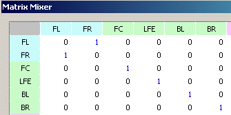

  25. hey, how to swap Left and Right Channels when encoding AC-3 to AAC using Nero?
    what are the switches?
    Can it be done with BeSweet?
    Is there any way or any tool that can do this in AAC tracks without reencoding?
  26. I don't think the Nero encoder has switches for swapping channels around.
    If you use foobar2000 for re-encoding, you can use the Matrix Mixer when converting (it's a foobar2000 DSP). I only discovered it myself yesterday (I've used foobar2000 for years).
    https://forum.videohelp.com/threads/367078-Need-advice-about-mixing-5-1-down-to-stereo?...=1#post2345508
    It's configured for downmixing to stereo in the screenshot in the post I linked to, but it's easy enough to use it to swap channels around. By default the input and output channels are all matched. To swap the left and right channels you'd do this:
    Name:  swap channels matrix.gif

    If you can decode via DirectShow when re-encoding, ffdshow's audio decoder has a filter for swapping channels, or it's mixer filter can do it also.
    I don't know what BeSweet can do. If there's a way to swap channels without re-encoding I'm not aware of one, but that doesn't mean it's not possible.
