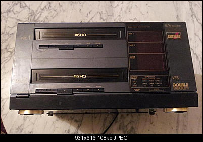

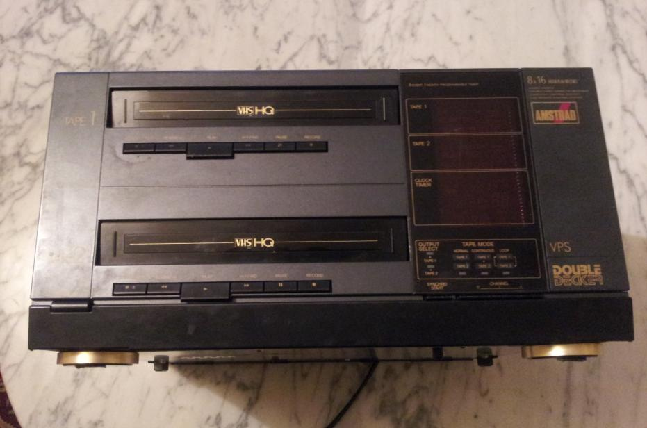

    If it's a true double decker vcr then it's very rare,the only type that are top loaders that i've seen are more of super nintendo type of insert,post a pic when you get it.
  27. Super nintendo type of insert? Do you have a picture to clarify?
  28. I'm a Super Moderator johns0's Avatar
    canada
    Something like this.
    Its actually on its back so it's a front loader.
  29. Ah Amstrad. Those things lasted a week at most then self destructed. She said that it was a normal top loader though
