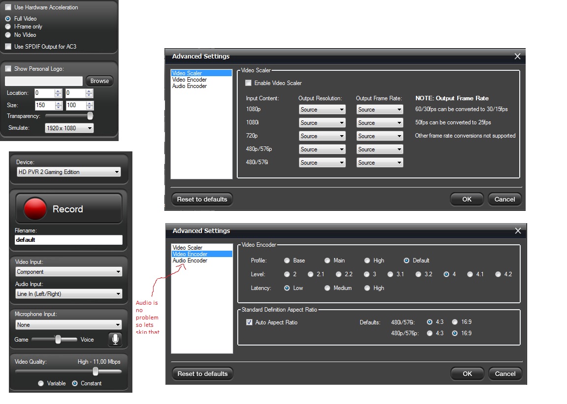

    the options, all there is
  15. Try the "No video" option.

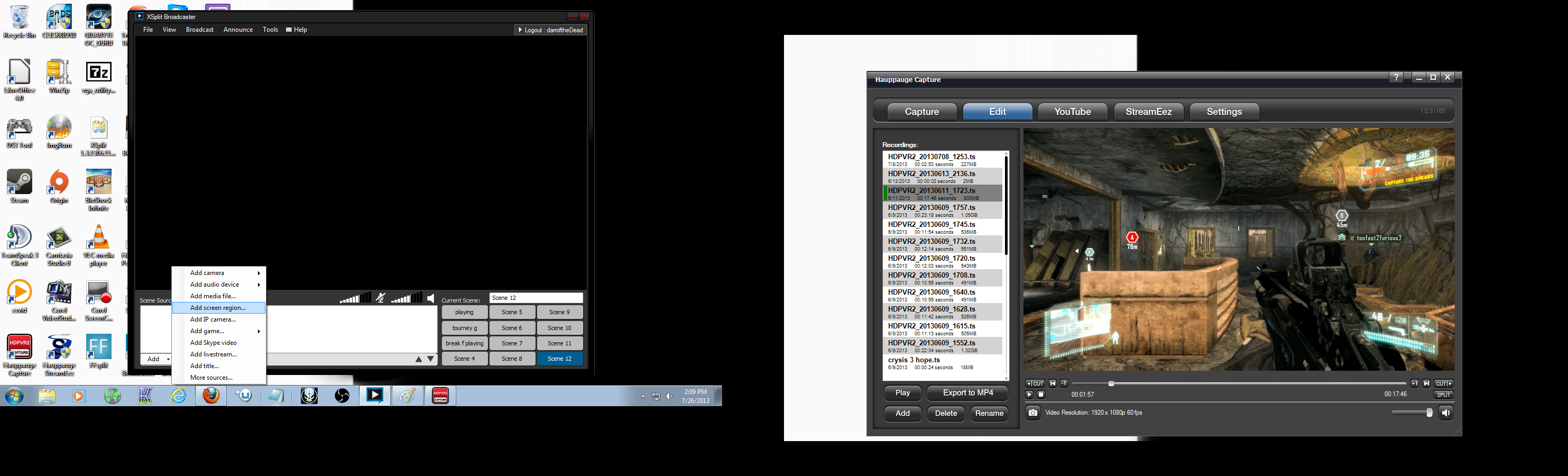

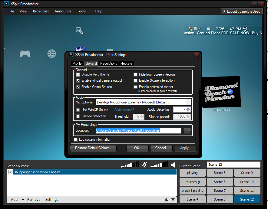

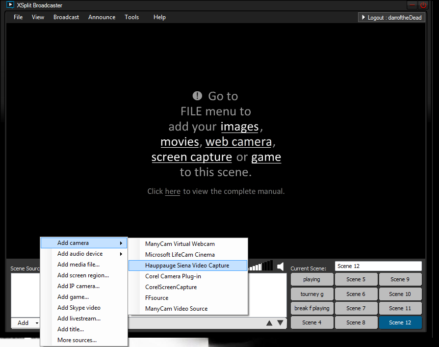

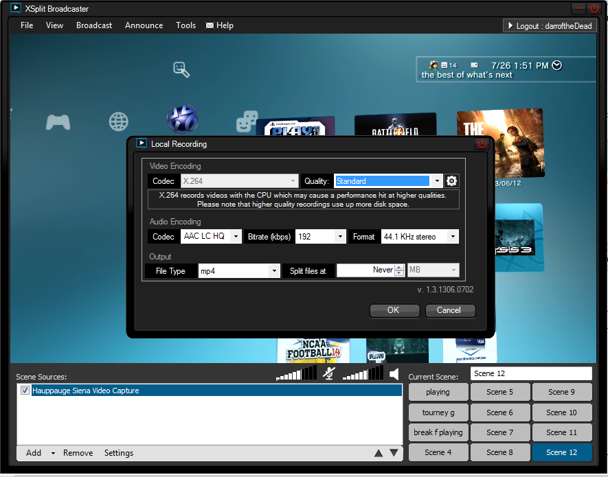

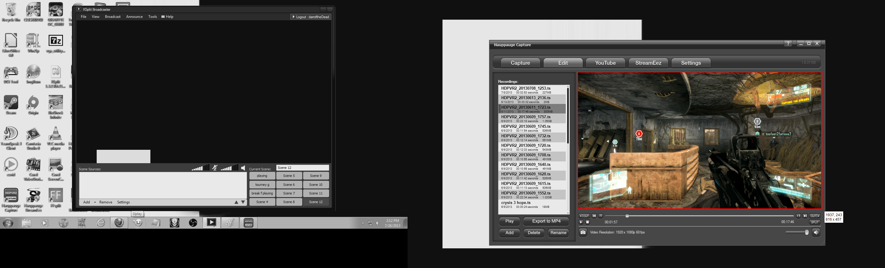

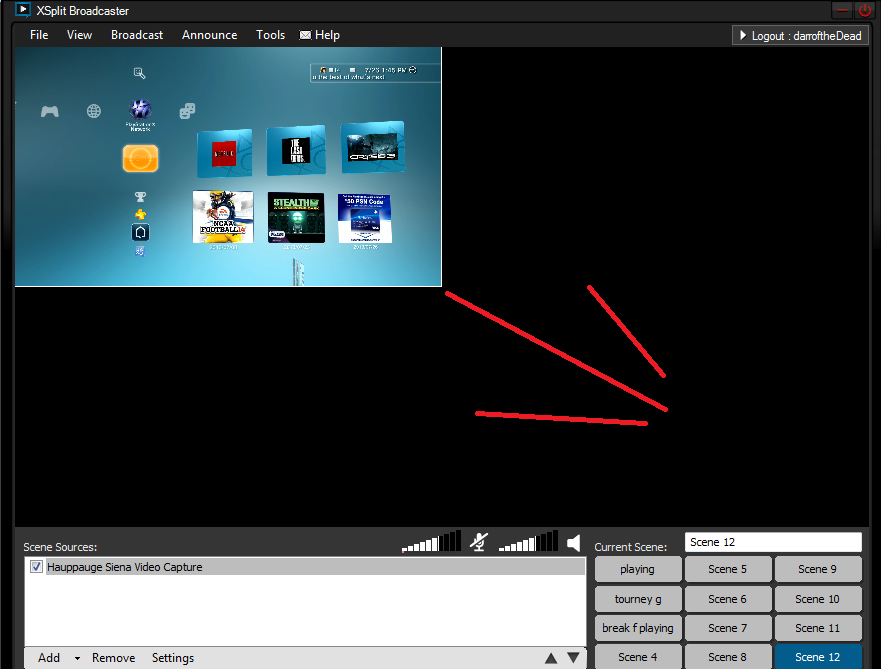

  18. in the bottom left hand corner select add----add---add camera----hauppauge siena video cature, then stretch it to fit the canvas. under tools---setting---- general--- near then bottom you should be add what folder your videos goto. under braodcast---local recording should see a settings emblem next to it click to adjust some extra setting like video quality. i have the paid for version so some settings locations maybe else where don't panic just look around. and if the local record isn't under broadcast just add it.
    *click image then click the the new image again to zoom

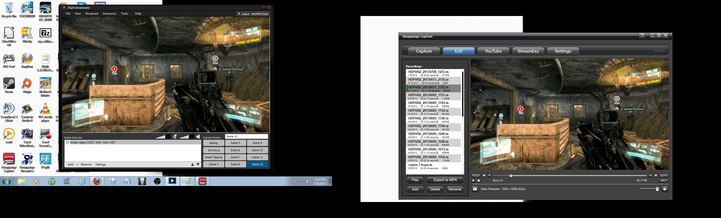

  19. as for your previous recording if you can get them to play in Hauppauge capture or anything else use the region capture and let xsplit re-record the video

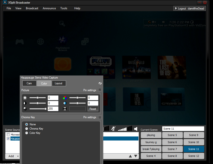

  20. oh yeah almost forgot if your video image is dark you can right click on your source and adjust color settings
