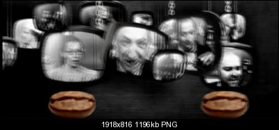

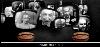

Name:	Final image.png
ID:	18993Click image for larger version
Name:	Image preview.png
    First is final image and second is Preview image
    Ty for fast respond
  4. Those images don't help. Since everything is in motion there's no way of determining if the fields are in the wrong order. It's best if you post a video sample of the source. Or a still shot with both stationary and moving objects. Or just use VirtualDub's Swap Fields filter and see if it gets better.
    I don't need to see the preview image because it's been deinterlaced with a simple bob.
