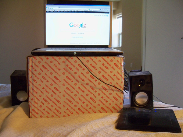

    My laptop sits on a cardboard box with the top cut out. Inside is a household fan blowing directly into the vents under the machine. Ordinary laptop coolers, even a super duper one with 3 large fans, could not keep this laptop cool. The temps mentioned in my last post are the coolest it ever gets even with my special arrangement.
    Jan 2011
    Canada
    For your entertainment, this is what that wacky arrangement looks like (14" fan in there, blowing up at medium high speed):

    Cool (pun intended). I read elsewhere that 50 to 80 C is not unusual for later generation intels, so you're not seeing anything unusual. What's unusual is that you wait so long to power down or reboot to refresh memory. When I work with video all day I reboot several times. Especially when the mouse starts stuttering.

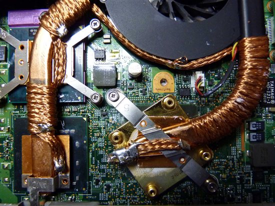

    I think the solution below may be even better. Haven't done it, but may try it. Honestly though, I get the temps down low enough with the fan setup shown in the pic above. And, all videos ran fine whether the laptop was hot or cool (ish) up until recently. No idea what happened. The thermal paste you mentioned I think is the same one I used btw. I don't think temperature is the problem especially since I can sometimes instantly fix video playback simply by maximizing the player console.
    I have BI0S REV A12.
    The braided wire mod is from:
    http://en.community.dell.com/support-forums/laptop/f/3518/t/19259944.aspx?PageIndex=3
