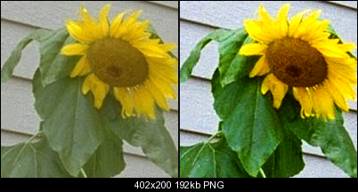

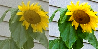

    ....adjust levels and saturation. No sharpener used. It could use a touch of denoising, though. VirtualDub.

  22. ....adjust levels and saturation. No sharpener used. It could use a touch of denoising, though. VirtualDub.
    you made it really...i mean really better. SONY will definitely hire you for sure.
    [Attachment 18976 - Click to enlarge]
    Wow! That's a pretty nice improvement. Tell me what you used to get such an improvement with v-dub. Thank you!

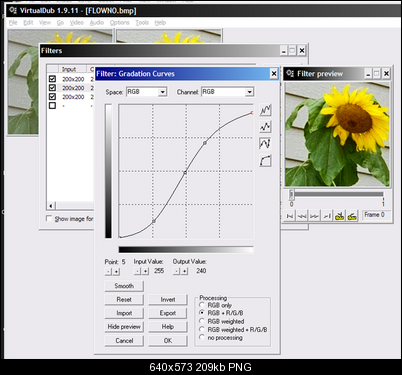

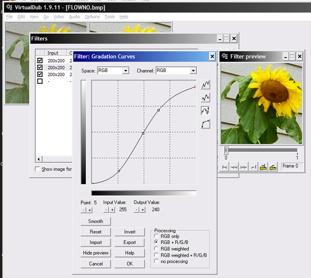

    Levels (built-in) ==> overall gamma, white level
    Gradation Curve ==> Black level, contrast, RGB 240 cap
    ColorMill ==> middle point, saturation, zero-black limit
    ColorTools 1.4 ==> histogram
Name:	Vdub filters2.png
